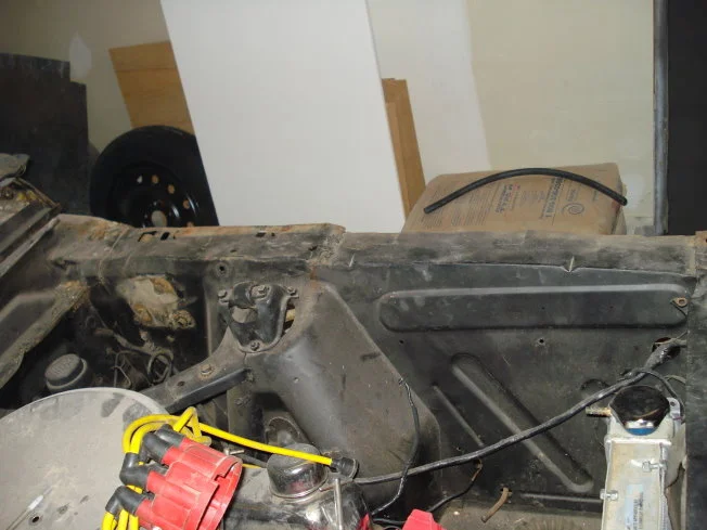

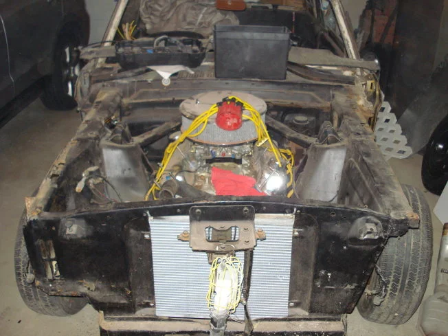

Ok, i've gotten dimensions previously from this website, and all the corners seem to be lined up pretty well in the engine bay, BUT, the guy did a bit of a hacked up job.
I'll show you the pictures. What do you recommend? Looks like he bought a front inner fender patch panel. I was thinking of buying the rear patch panel and a radiator support piece and putting those in so it's straight.
Help me with suggestions!
pictures are attatched i believe

Hard to tell from the pics but it looks like he welded a piece on top of the upper apron above the shock tower area? It looks like it sticks up higher and may make your hood bulge there? If so I'd figure out how to cut/gring that off and weld a stock size piece in at the same level and fill as needed to get level. That's a common area where water/rust gets trapped in the center of ~5 crimp welds from the factory and a rust bubble hump develops, had to cut/grind mine out (golfball sized hole) and had a filler piece welded in to be flush.

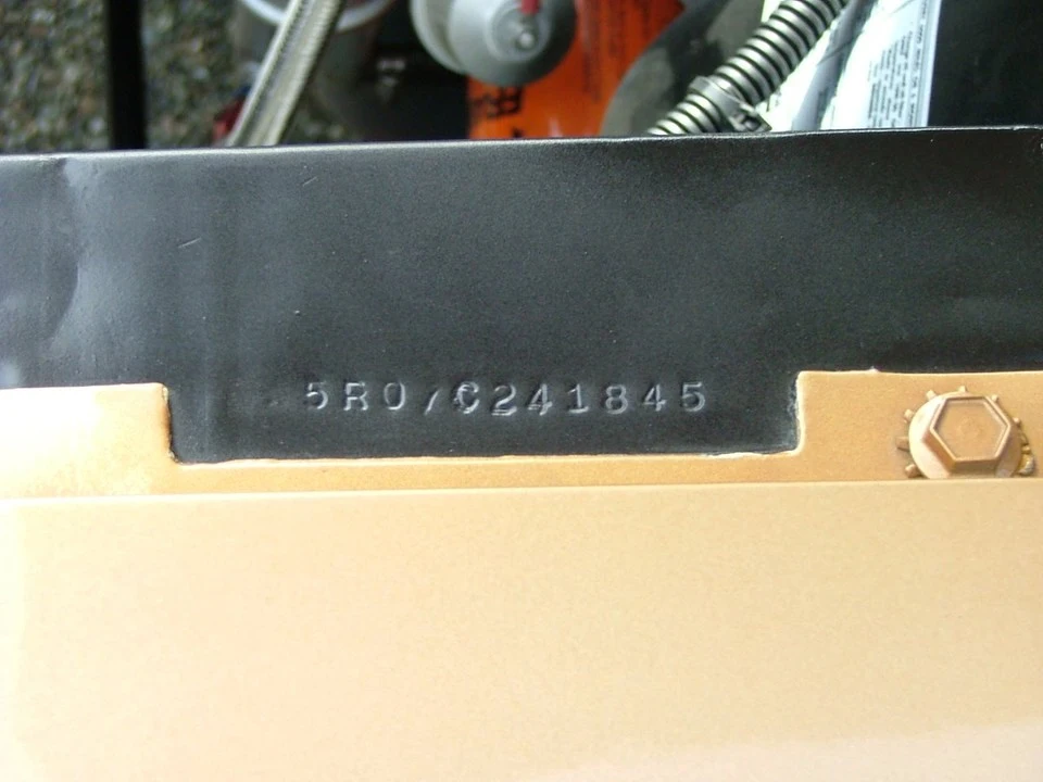

Between the shock and hood hinge? That establishes the car's bona fides, but that's the hidden VIN. The one you'll need is between the shock and the LH headlight. There is a notch in the fender to expose that one. Without it, you may have a problem with the DMV.
The VIN shown here is a restamp:

If it was me I would do something about the way that's welded, it may be fine structurally but it sure doesn't look right. Cut it up and butt weld it so it looks like the one piece it should be
