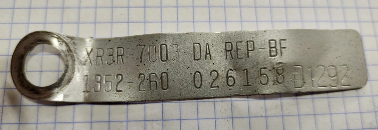

Hello StangNet members,
I need to repair a 5 speed transmission which is installed in a 1968 Ford Mustang, the synchronizers need to be replace, I only have the tag number, Does any one know where can I purchase these parts? Tag No. is XR3 R - 7003 - DA - REP BF 1952-260-06158-D1292.
Your help is very much appreciated.
1352-260 identifies it as a 1999-2000 Mustang V6 T5 transmission.
Xr3r-7003-da is the Ford engineering part number
If you look on the side of the main case, you might see a circle cast into the case with a number inside. That's the year of the casting
