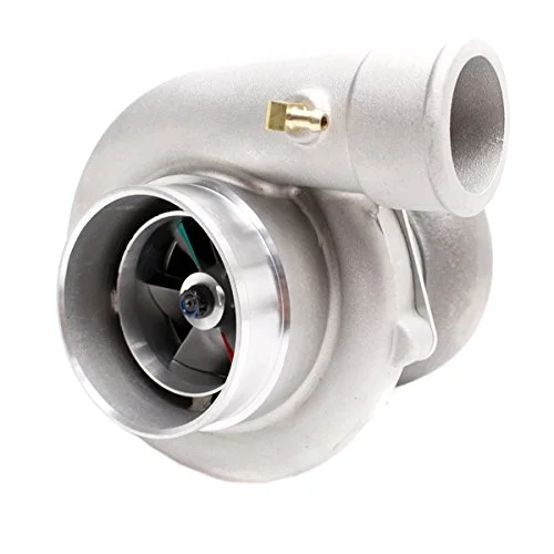

Somebody please post a pic of a GT-45. He wants to have a 200.00 chunk of aluminum sitting on his shelf in his bedroom so he can show the Xbox homies.
Aww never mind,...ill do it.

Here ya go. Exact same turbo I got on the engine in my car. More than enough to cause your stock block to fail.
Impress you friends, and be the envy of your adversaries for the bargain basement price of 278.
Amazon product ASIN B013FEVYHUView: https://www.amazon.com/gp/product/B013FEVYHU/ref=ppx_yo_dt_b_asin_title_o02_s00?ie=UTF8&psc=1
