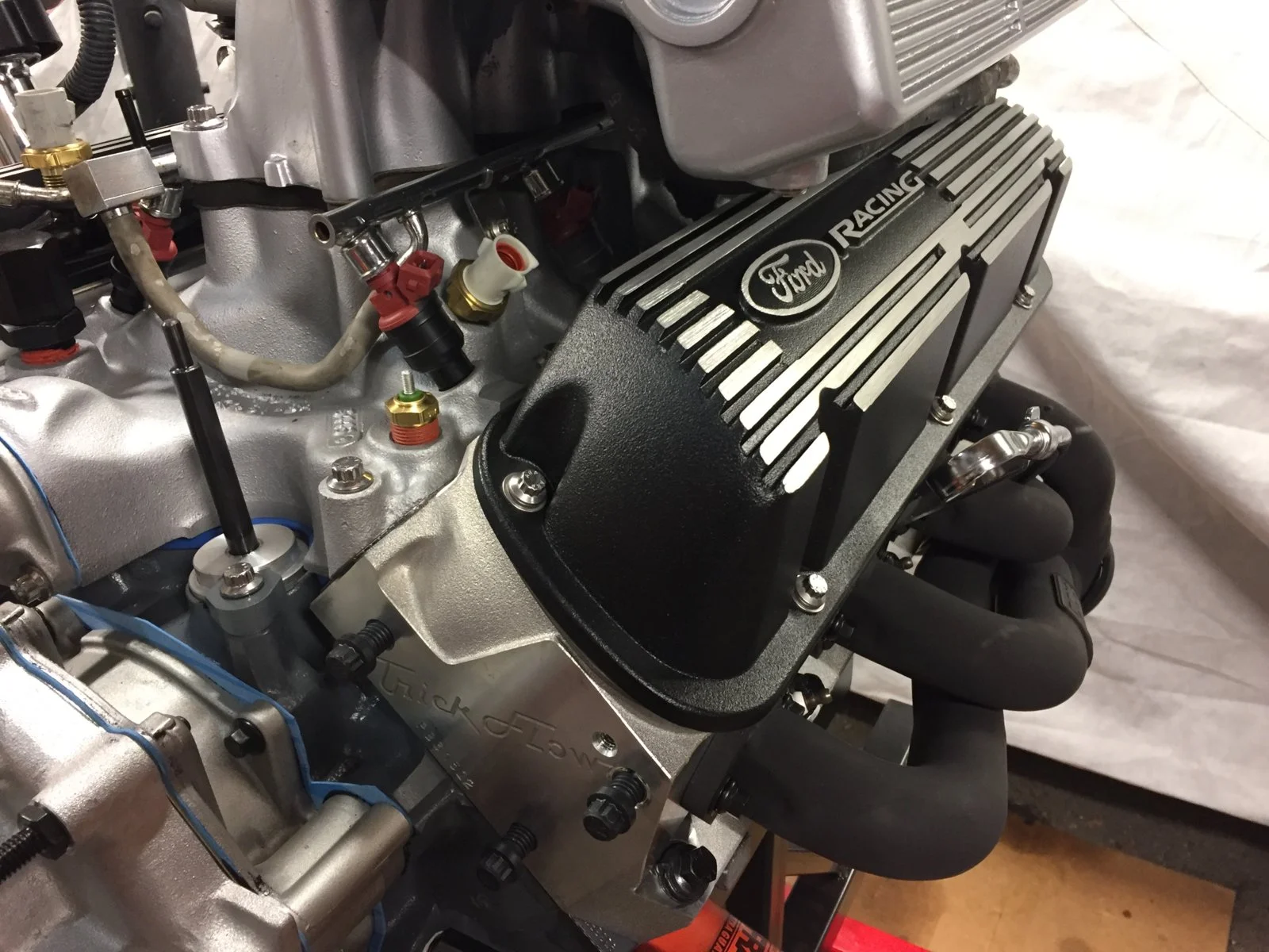

Sorry for the lack of information, I have a 1” spacer and an aftermarket hooD so height isn’t an issue. I purchased these about 5 minutes ago. They look similar to Mustang5L5s covers
