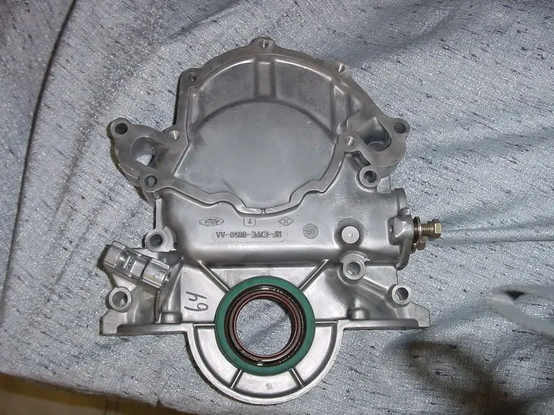

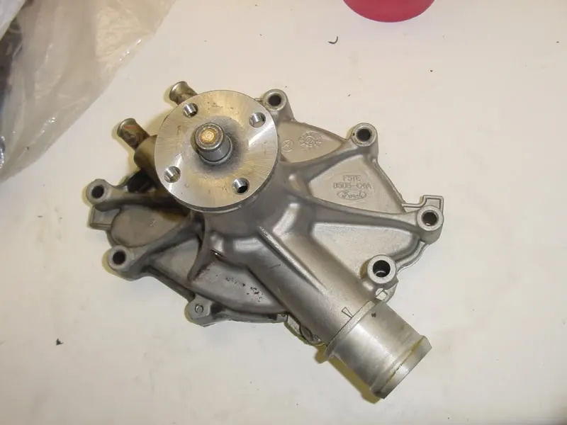

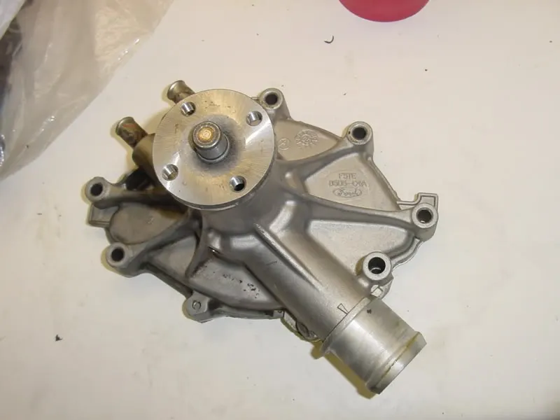

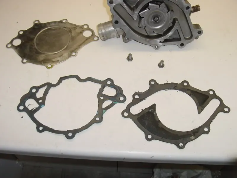

This is the waterpump, plate and gaskets:
WP is PN: F5TE 8505-C4A
and Timing cover PN: RF-E7PE-6059-AA

Tim,
You may try a 1996 Explorer 5.0L water pump. That pump looks just like the one that came on my Explorer engine. If that doesn't work, a 1995 F150 5.0L waterpump should work since that's what the F5TE part number on the water pump is coding for.

You've got a reverse rotation pump on a std rotation timing cover. See the pics I have of both here baddad457 - Photobucket - Video and Image Hosting The timing covers are on page 2 there. The one without the fuel pump boss is the one that fits your waterpump. The one with the fuel pump boss is a std rotation cover and the only reverse pump that fits it is the 79-85 Mustang pump. If you'll notice, the coolant ports are reversed from each cover. Your pump will bolt up to the std cover, but the ports don't match the flanges, that's the source of your leaks. The Explorer pump doesn't fit either of these covers at all. It requires a completely different timing cover. That cover was used on the 88-93 T-Bird/Cougar 5.0 , the 94-95 Stang 5.0 and the 96-2001 Explorer/Mountaineer 5.0
Thanks, I never realized when I took the back plate off that the swirl of the reverse flow pump doesn't match the swirl of the timing cover. I guess it doesn't matter since the holes in the backplate are round. In my case it's also acting like an "adapter". I think a lot of the FRPP SBF crate engines are like that because they have the timing cover with the Mech fuel pump boss.
I went to another Checker (the local warehouse) and the counter guy was able to match them up easily. Both for under $6. He wasn't able to tell me the application, but now that I have the right gaskets, the WP to backplate is Fel Pro Part # 35380 used on 86-95 SBFs
and the WP to timing cover is Fel-Pro # 35211 which is used on 65-95 SBFs

If you'll go look at the two covers on my photobucket site,(see the link above in post #4) you'll see what I'm refering to here. The 86-up pump will physically bolt up to the std rotation timing cover, but the ports are reversed and do not match the porting on the std rotation cover. Ford actually had 4 different reverse rotation waterpumps. The 1st was the 79-85 pump, which does match up and fit the std rotation timing cover. It however was lacking in efficiency due to the impeller spinning backwards. Because of this, the coolant had to make (in effect) a U turn to enter the coolant ports in the std rotation cover. To correct this, Ford in 1986 redesigned the timing cover for the Mustang and reversed the porting (see my photobucket pics) and the waterpump to work better in the rotation it was turning. This pump was also used on the 86-97 pickup and van 5.0's, along with the 351W in these applications. The other two reverse pumps are the 88-93 T-Bird/Cougar & 94-95 Stang (same pump for all three) and the final version of the reverse pumps, the 96-2001 Explorer/Mountaineer. This pump is slightly different from the T-bird/Cougar/Mustang pump but fits the same timing cover. The E7 prefix on that std rotation cover was for the application it was used in: the 86-91 Crown Vic/Towncar/Marquis 5.0, in which all three used a std rotation waterpump. Apparently whoever edited Ford Racing's catalog isnn't the only person confused by all the revisions over the years in the Front End Accessory Drives ( refered to as "FEAD" by Ford) Once again I'll state that the ONLY reverse rotation pump that fits (correctly) and works with the std rotation cover (albeit not the best efficiency in operation though) is the 79-85 Mustang pump. The steel backing plate pictured above is basically a bandaid approach to adapt the wrong pump to the std rotation cover. It apparently works, until the waterpump bolts loosen and release the compression on the gaskets.
