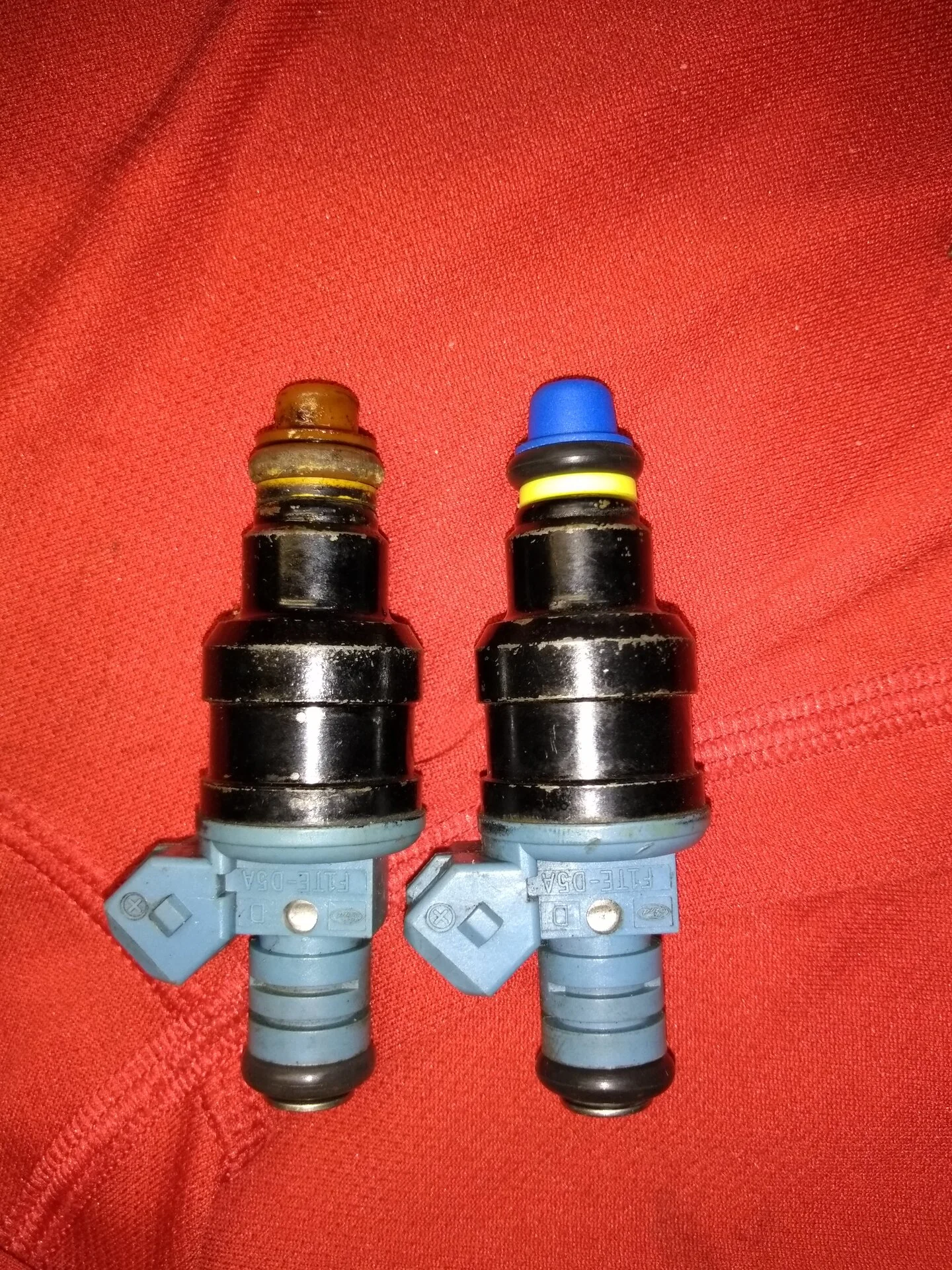

Just replace some of the parts on the injectors. I recently did.
