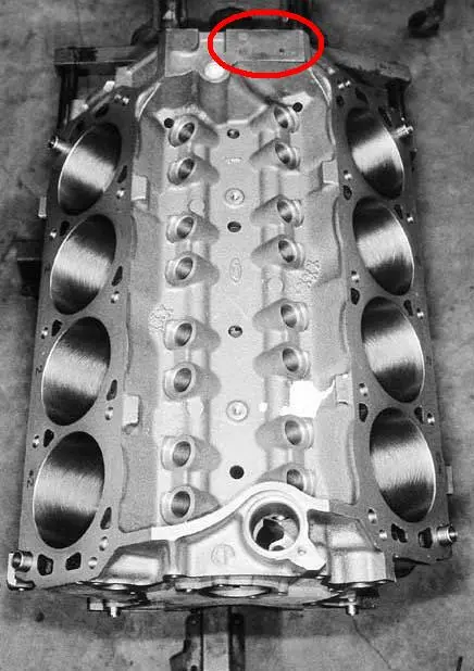

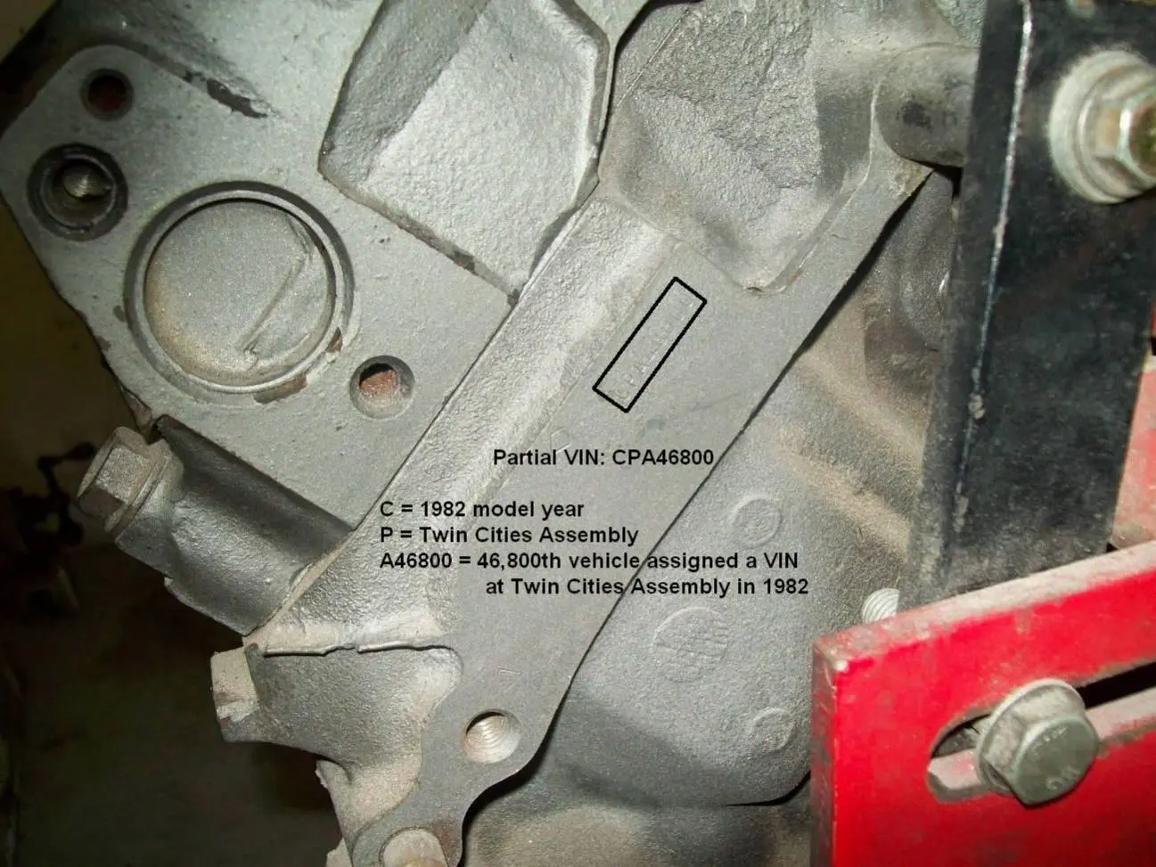

There is a partial VIN stamped to the block. That WILL tell you the year and model that the block was originally in. It's either on the driver-side rear of the block, below the deck on cylinder #8, OR it's on the top-rear of the block, on a flat pad behind the lifter valley seal.
