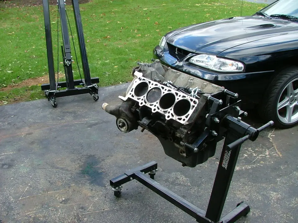

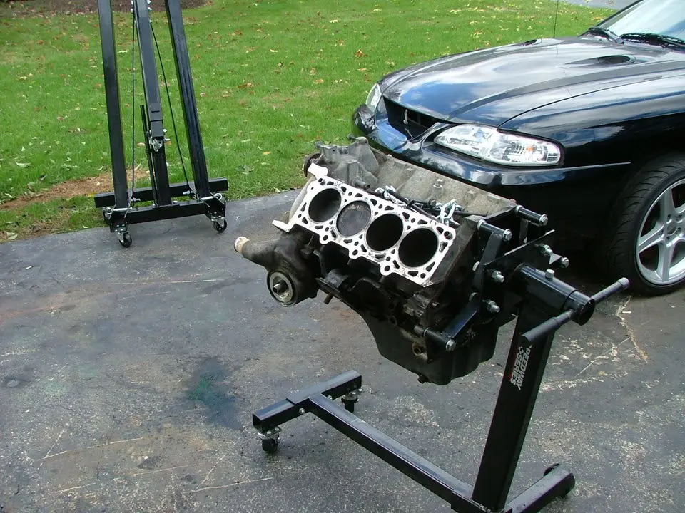

jstreet0204 said:
There is something VERY satisfiying about putting together a clean motor on an engine stand.
yup
:drool:
