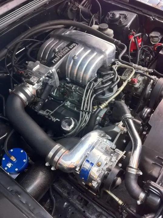

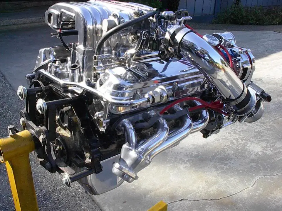

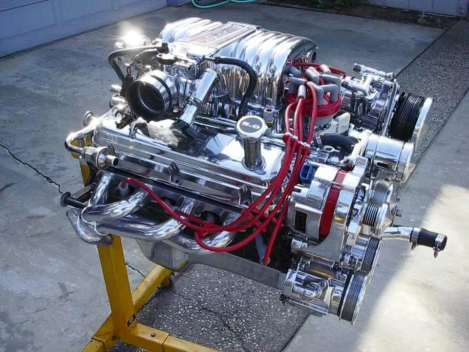

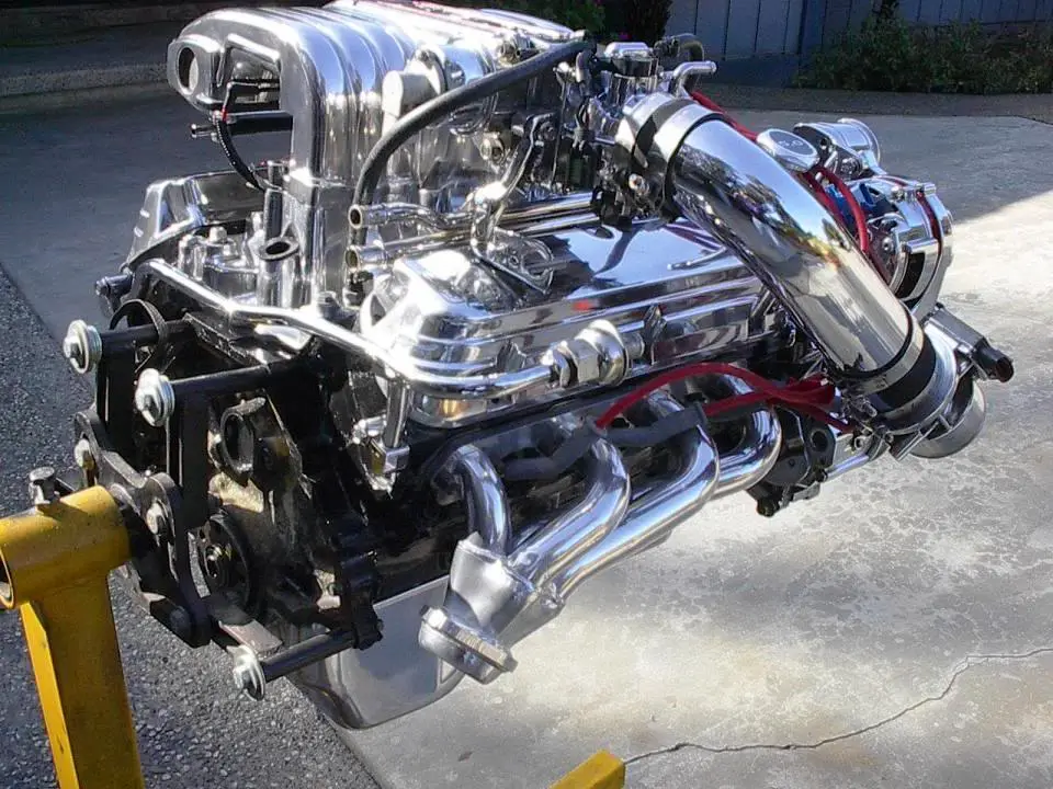

POR 15 IMO:nice::nice::nice:
It still looks the same after 10 yrs........... and even with BLACK it's never once over heated.

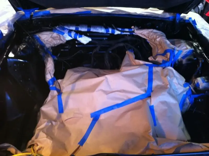

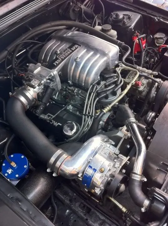

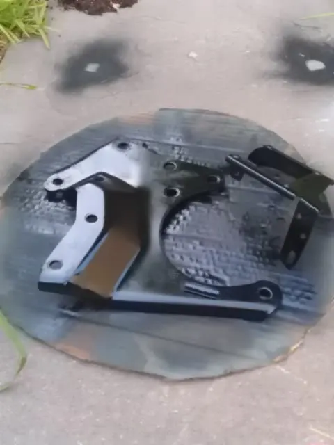

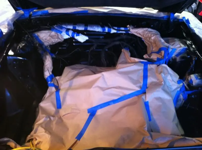

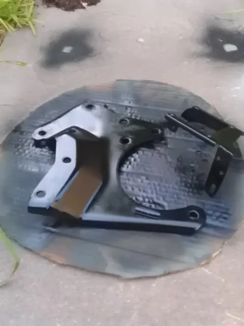

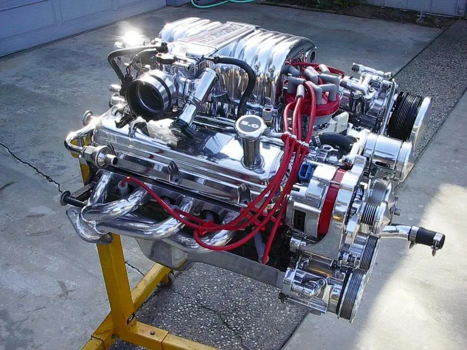

Lots of break clean ($2.97 per can at Walmart) to clean the grease off, use compressed air (air compressor) to further dry brake clean and removed dirt. I also used VHT 1200 Black. Can use the Duplicolor 500 Degree Black High Gloss, Rustoleum 500 Engine Enamel 500 Degree Black High Gloss as well.
The engine block on the 92GT came out so good we painted the engine bay while it was stripped down to the block. Man what a difference. Just need to redo in front of the powerpipe. The MAF use to sit there and scratched it all up. Also painted a bunch of brackets with VHT.
