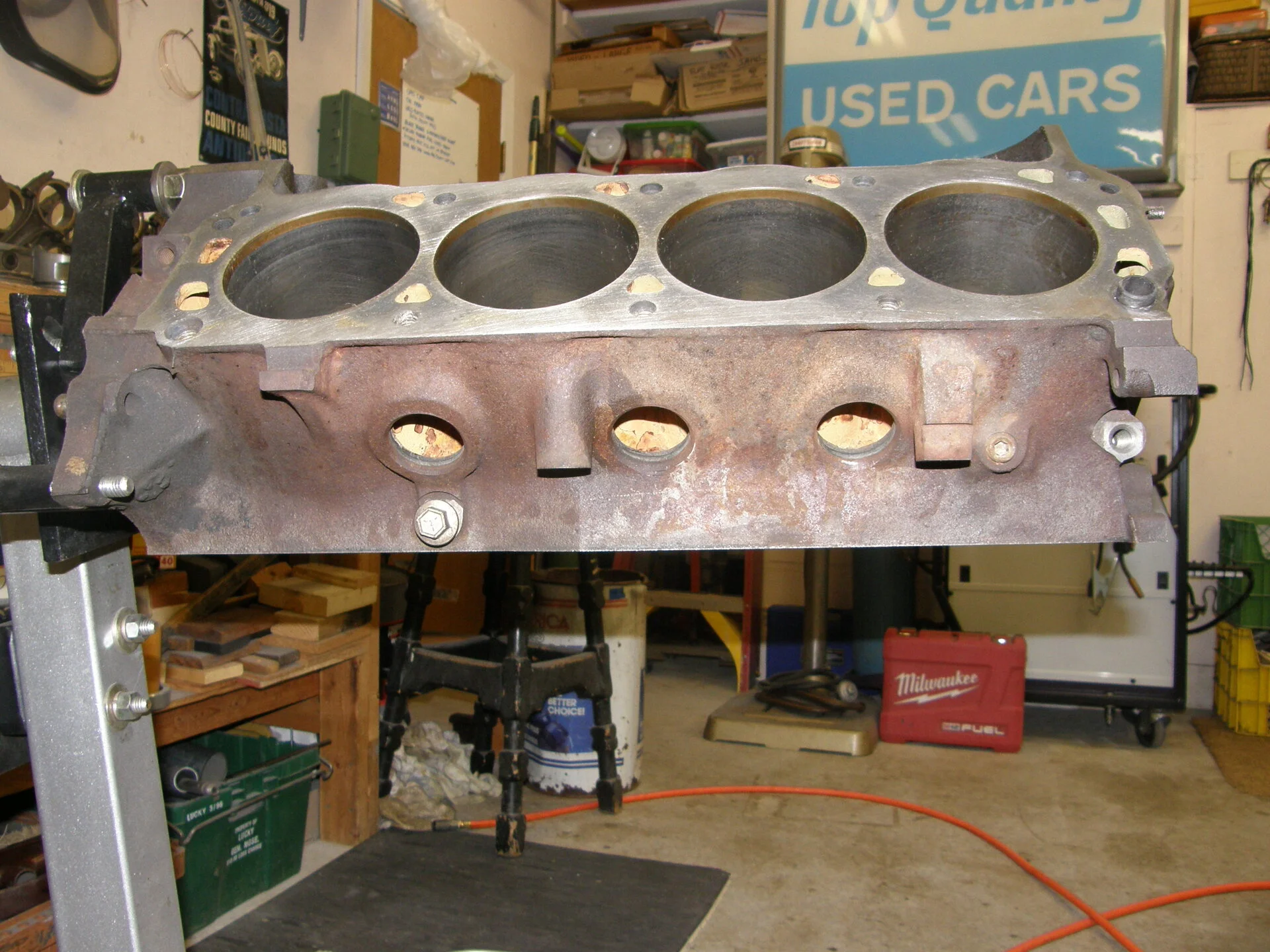

I'm doing a re-ring on my '93 5.0 motor. I need sealant to spread on the edges of freeze plugs before I knock them in and on the threads of oil galley plugs. What's a good sealant (oil and water resistant) to use? Brand and type, please.
