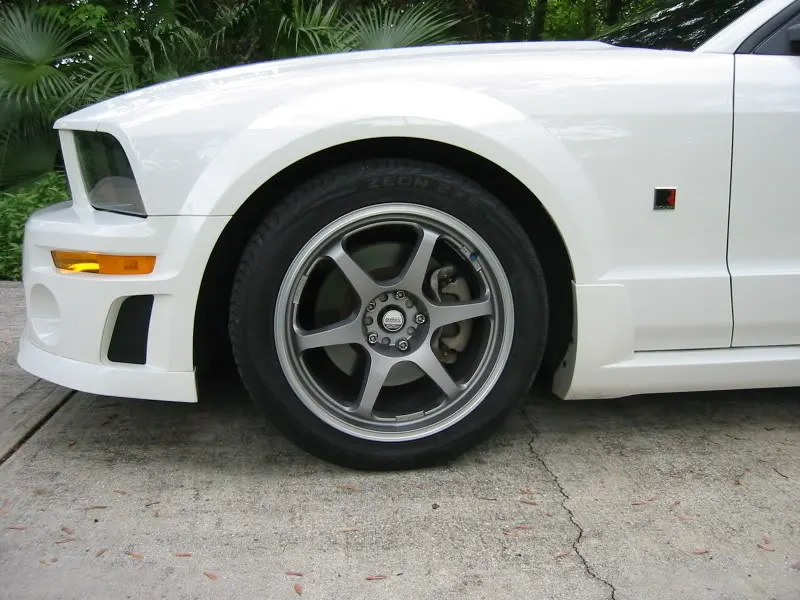

I wanted to know what size wheels and tire sizes most of you folks are running on these 05+ models.
I recently picked up an 08 and have identified the wheel style I want, but without friends or other cars to compare to, I having a hard time feeling confident on the size.
I have the option of going with a 18x9 all around or 18x9 front and 18x10 rear. I don't want larger the 18" in diameter.
The sizes pretty dramatically alter the available brands. Also, the notion of a 10" wide wheel seems radically wide to me. I come from Fox and SN95 models and 9" is the widest I'd ever go with these cars. I feel pretty confident a 10" won't go on the rear of a Fox without clearance mods. This has me timid about the choices.
The tire sizes I am leaning toward on these wheels are a 255/45 with the 9s and/or 285/40 on the 10s. This would be with the Goodyear F-1s.
What combos have you chosen and do you have any online pics I can use to visualize the result.
Thanks abunch, Daren

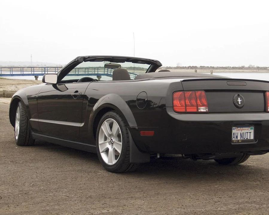

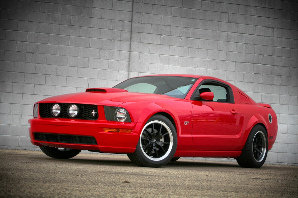

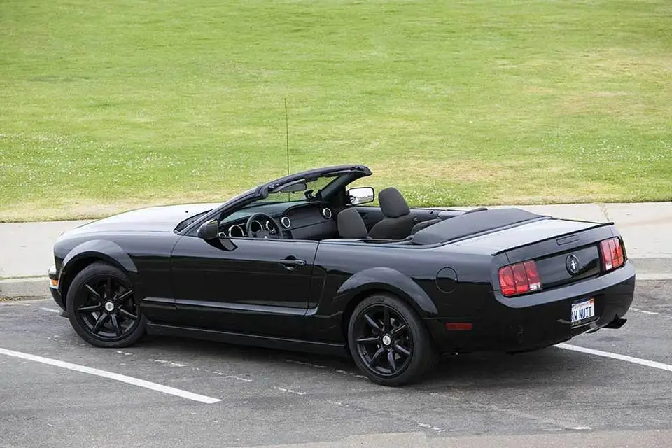

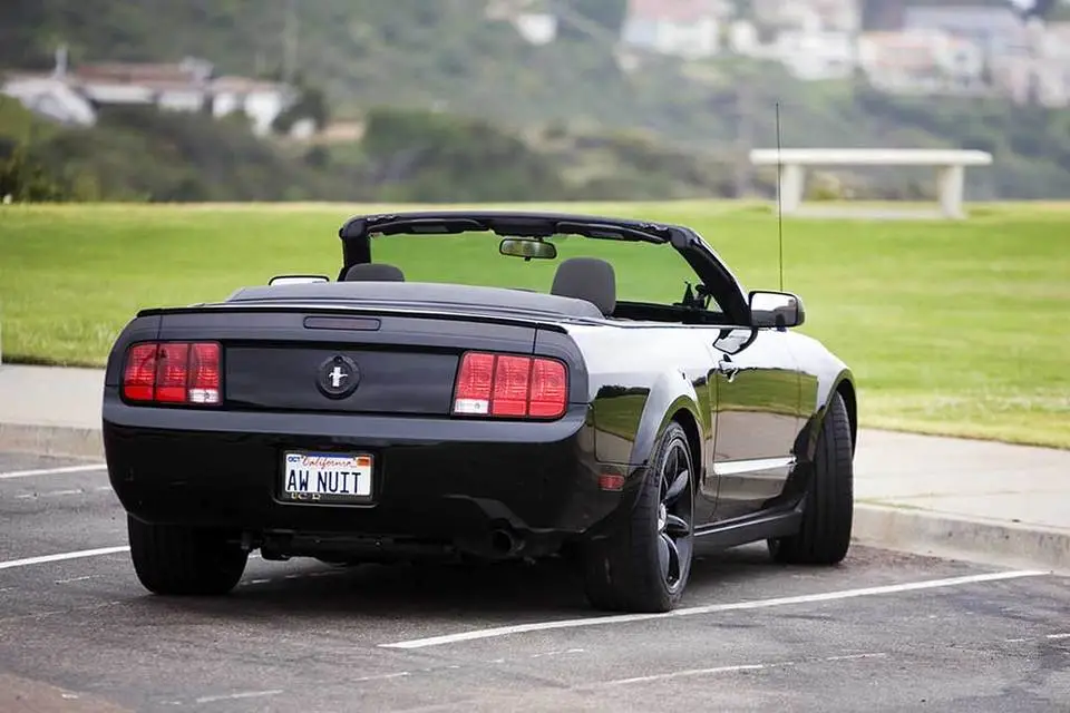

Daren, I'm running 20x8.5 up front and 20x10 rear. No reason to be timid about the rear, the space we have out back in the S197 platform is far different than years past. You can comfortably run big wheels and most big rubber 305-315.
I know your not looking for a 20, but here's some 20x10 rear shots, don't forget, I'm lowered as well on prokit springs:

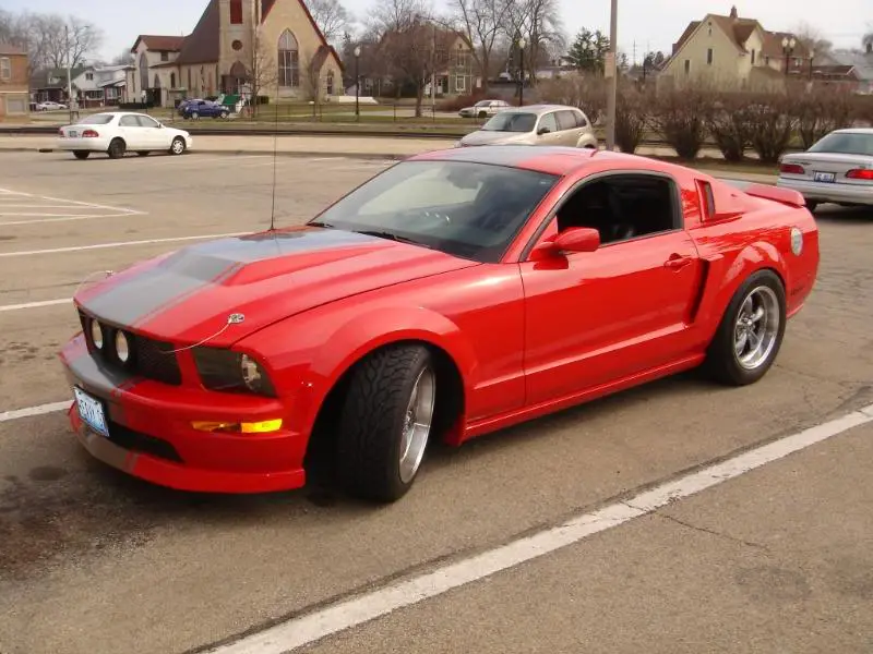

I found a 18x10 Drag radial pic I forgot about:
Whole rear with dr's, 18x10 Nitto 305/35/18

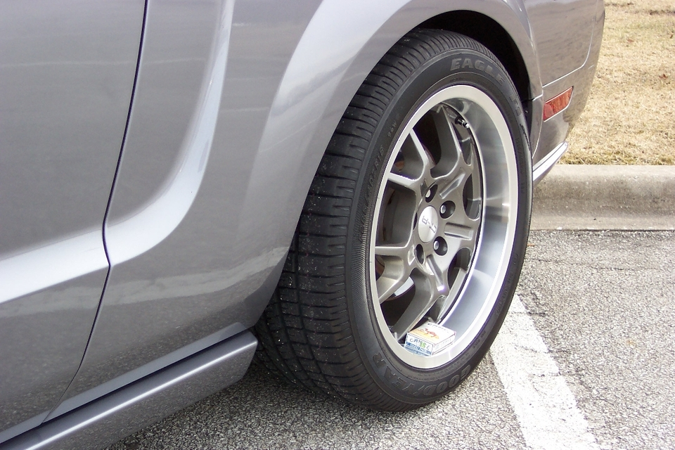

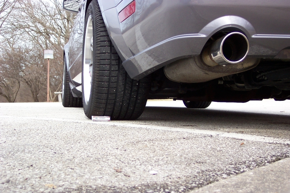

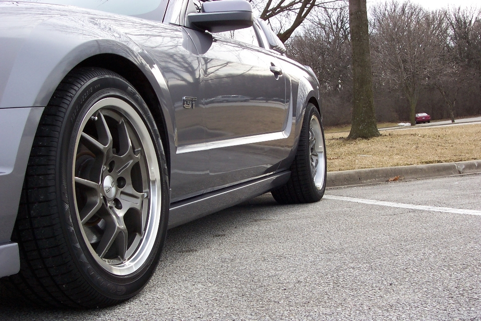

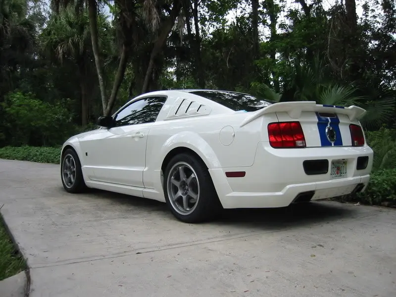

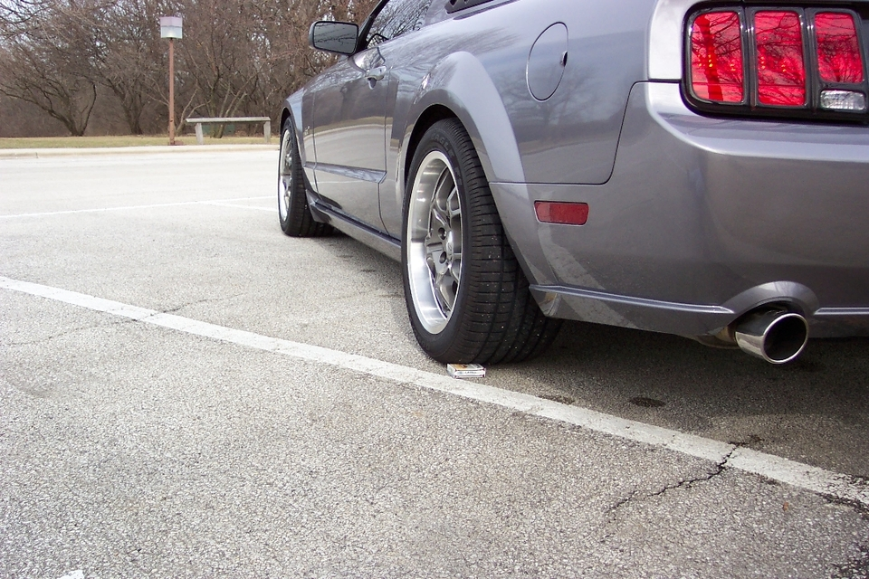

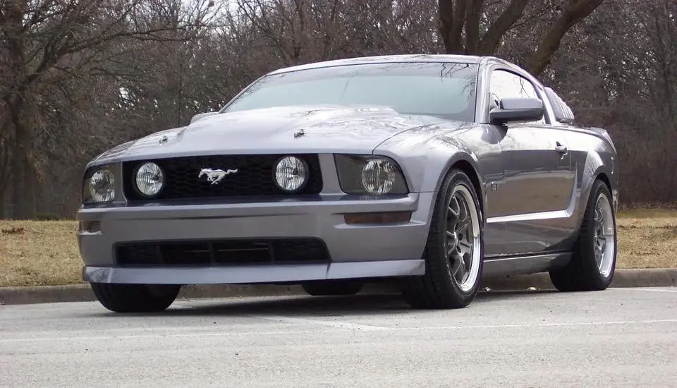

DarkFireGT,
I did follow your link in your signature and looked at the pics for your other GT, the gray one. You selected 255/45s on 9" wheels. Interestingly you selected a Magnum style as I intend to do as well. I'm looking at a different maker however, your pictures have me feel a bit better about an 18x9 setup for all corners.
As a side note, I couldn't help noticing the quarter window louvers you've added in place of the windows. I do like the flush look. Can you send me a link from where you sourced those? I can't say I will go so far as to add that mod, but I am interested to consider it.
Thanks, Daren
Thanks for checking out the site. Yep, that car has 18x9's all the way around on 255/45/18. I love the look of a meaty tire out back, and if they had those wheels in 18x10, I'd have done that to that one as well. But that's me. If you would like me to post a few larger pictures of that one, I'll do that as well.

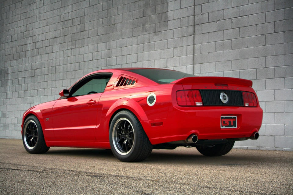

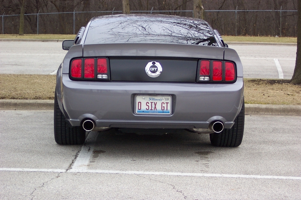

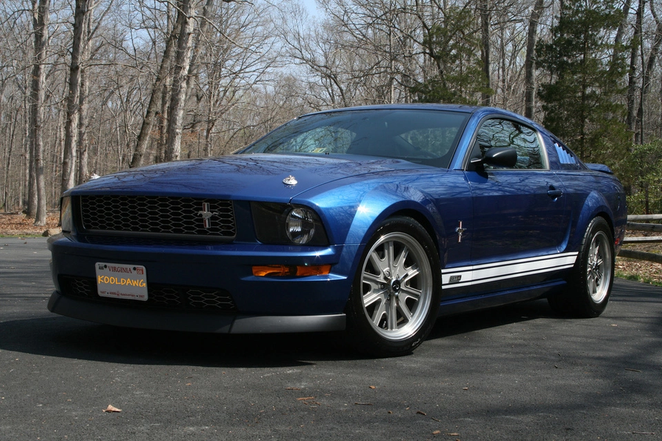

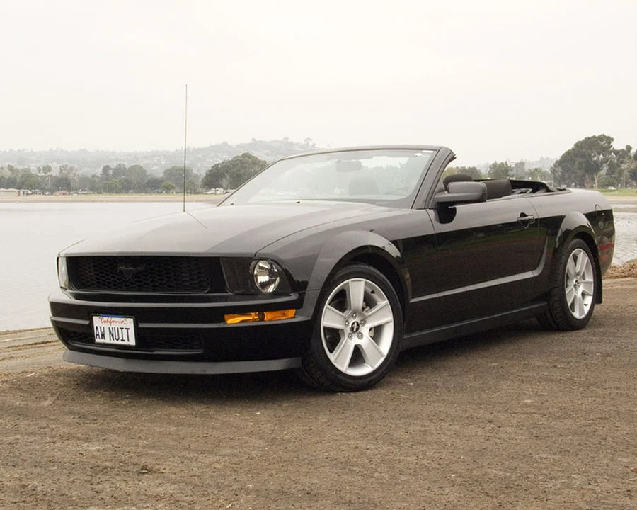

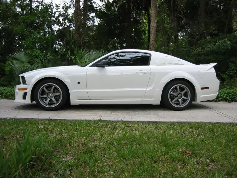

Although late to the ball game, I'll throw some of my pics in here as well:D
18x8.5 with 255/45 lowered 1.6" up front
18x10 with 295/45 lowered 1.25" out back
I can also vouch for the excellent quality of SHR products as I have 6 of their products(4 of which they make exclusively)!

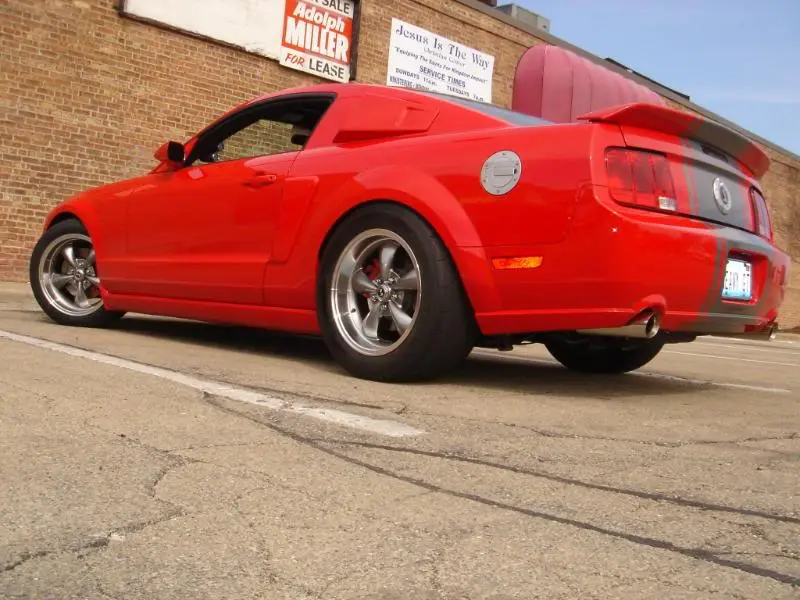

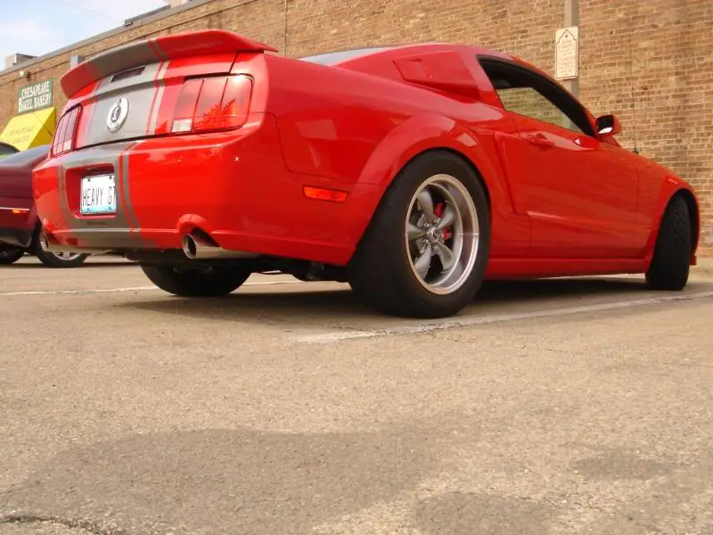

18x9.5 all around
Goodyear F1's - 255/45ZR18 Frt & 285/40ZR18 Rr

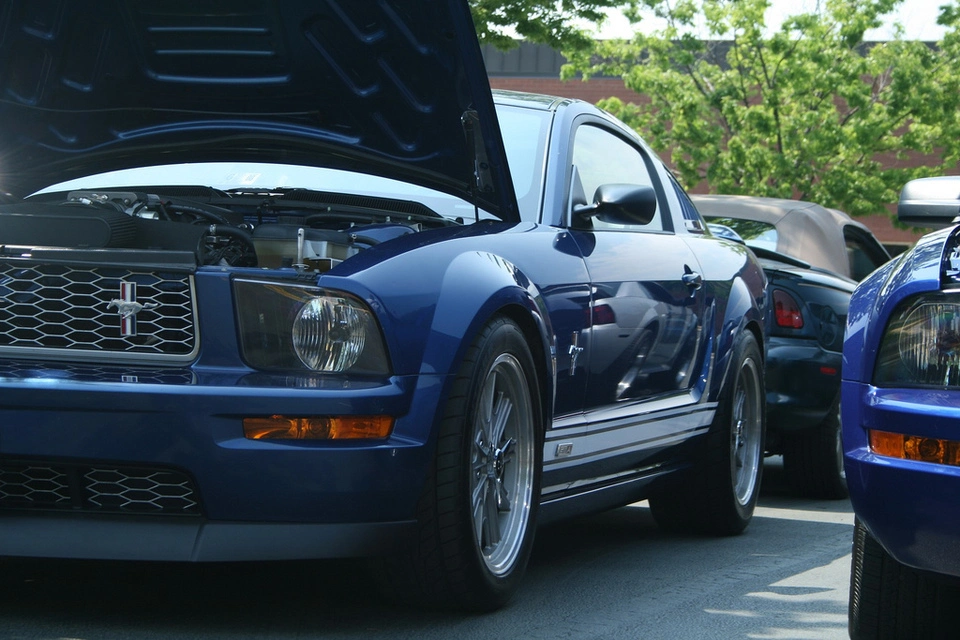

I'm running 18x9.5" wheels with Cooper 275-40-18 tires all around. I was consdering a larger tire but I got a smoking hot deal on these tires that were takeoffs from a Roush 427. The car is lowered about 1.6" with Vogtland springs.
