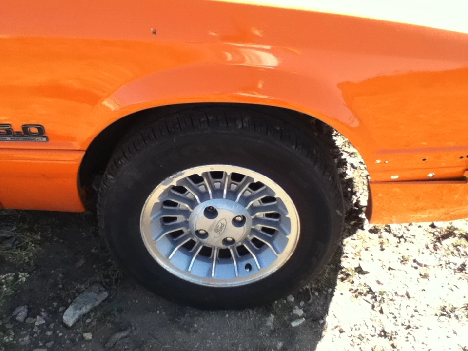

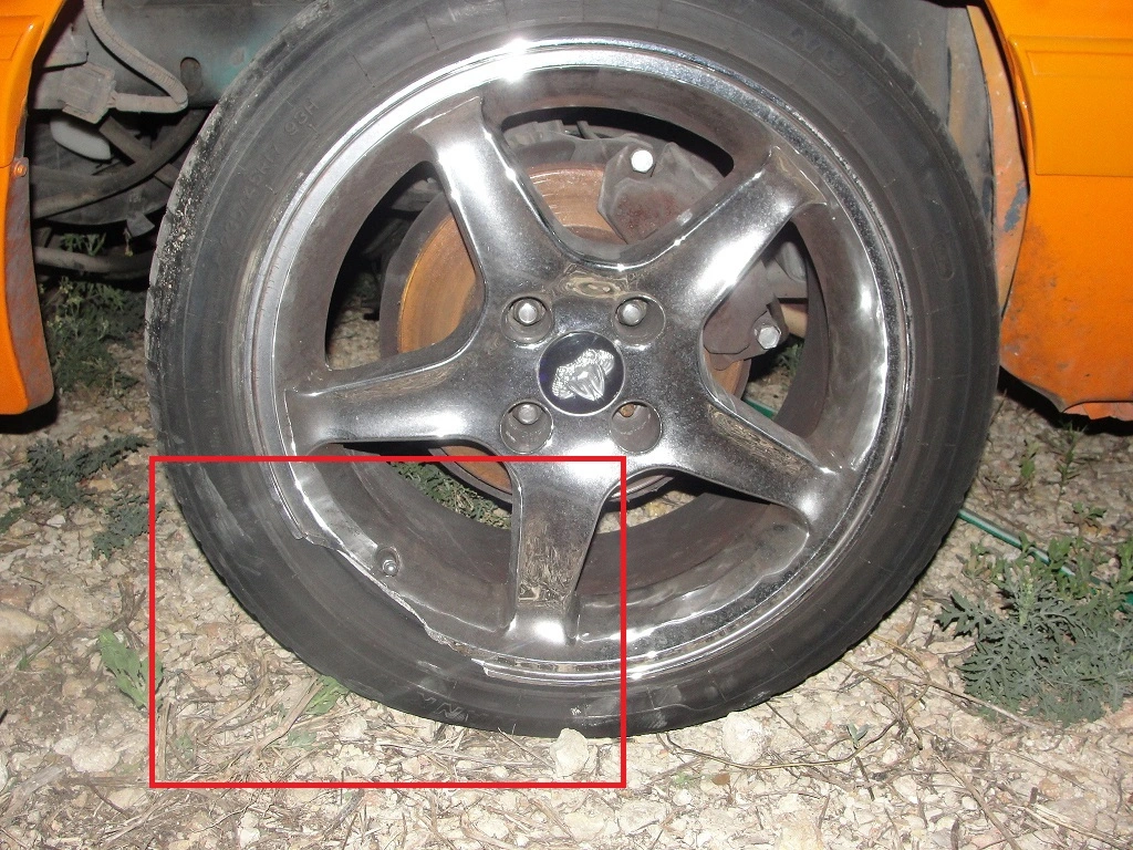

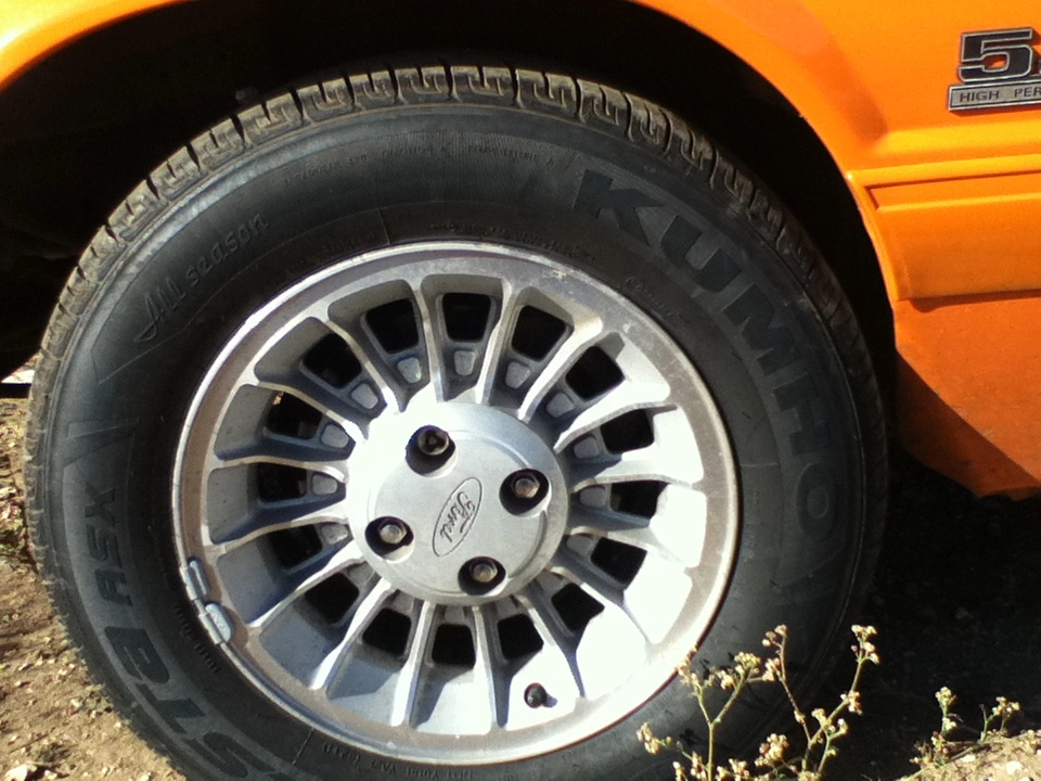

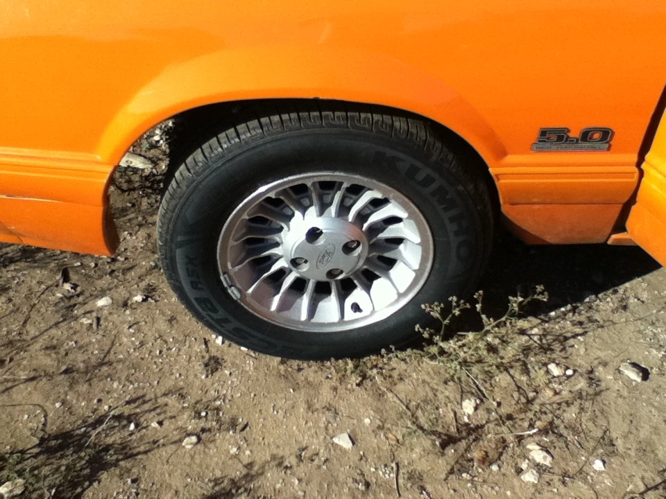

Sorry for the really really slow reply, im a bit lazy, anyways, pictures are in!
The first one is when it had the Cobra 17x9 rim on with a tire size of 235/45R17 93H
The rest are with a the 15'' turbines with a tire size of 225/60R15 96

The second image of the rim swiping the fender and having of bent it in a bit, it also hits inside the fender when turned in like that but I couldn't really get a picture of it.
And the last two pictures that have the "5.0" emblem on either side of the car is for comparison in space from one side to the other to show how far back the driver side wheel is.
I'll bet you a six pack that car was hit. Did you check the crush zones on the fenders (by the battery and air box) and underneath for frame damage. That wheel should be centered in the wheelwell. Stock K member?
+1 to something is really bent and it's time to get a frame/alinement check out if you are not ready to do your own alignment/alinement (depends who's spelling it-really. I do not care as long as the car goes straight and does not dart when they are done.).
The best part is the guy was driving on that Cobra rim like that....you can see why I got new ones.
Anyways, here's to hoping he didn't ruin the car that badly. Hoping it's the spindle..-___-

funnnny. The cobra rim didn't hit noticeably when I drove on those (didn't drive on the road). When I took these off I forgot where they came from on the car. I already had these pictures taken from when I bought it.
I simply didn't consider it, just called the rim trash and not worth a dime, since after I bought the new rims and tires I was just considering gaining back what I spent some.
The rims are not even in question, with that amount of rear dis-alignment, there is deff something bent, if not more than one thing. First it looks like a harsh curb, and if that drivers fender is original, I would be looking at the A-arm first, then considering replacing the k-member. There is something very wrong that is bent, and I doubt if it is a spindle, but more of a a-arm or k-member at the a-arm bushings area. From what I remember, the 2.3 and the 5.0 setups are of a different length, so not so much interchangeable. I would suggest going ahead and getting an aftermarket front end setup.
