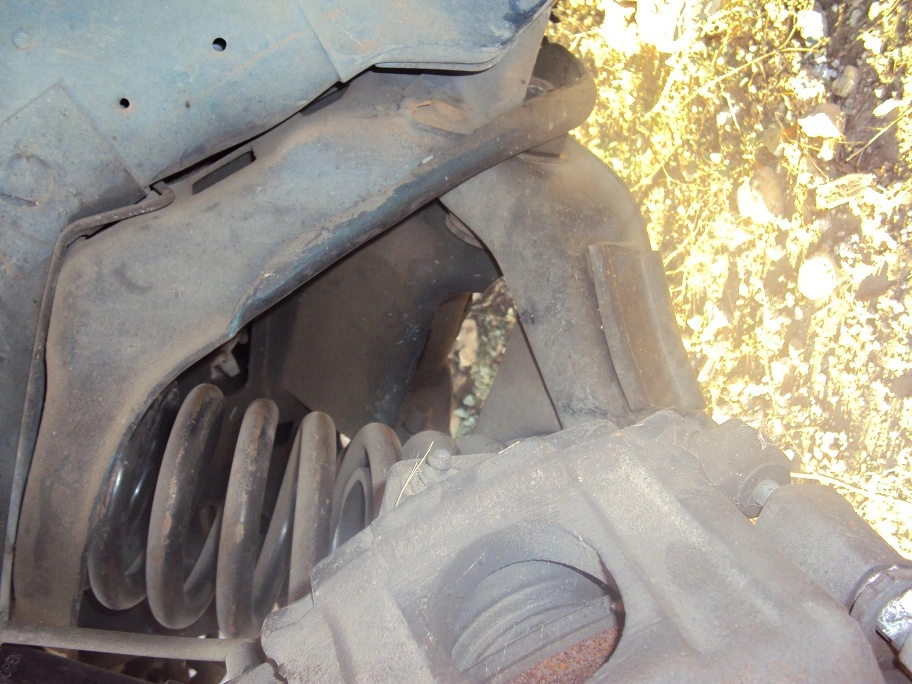

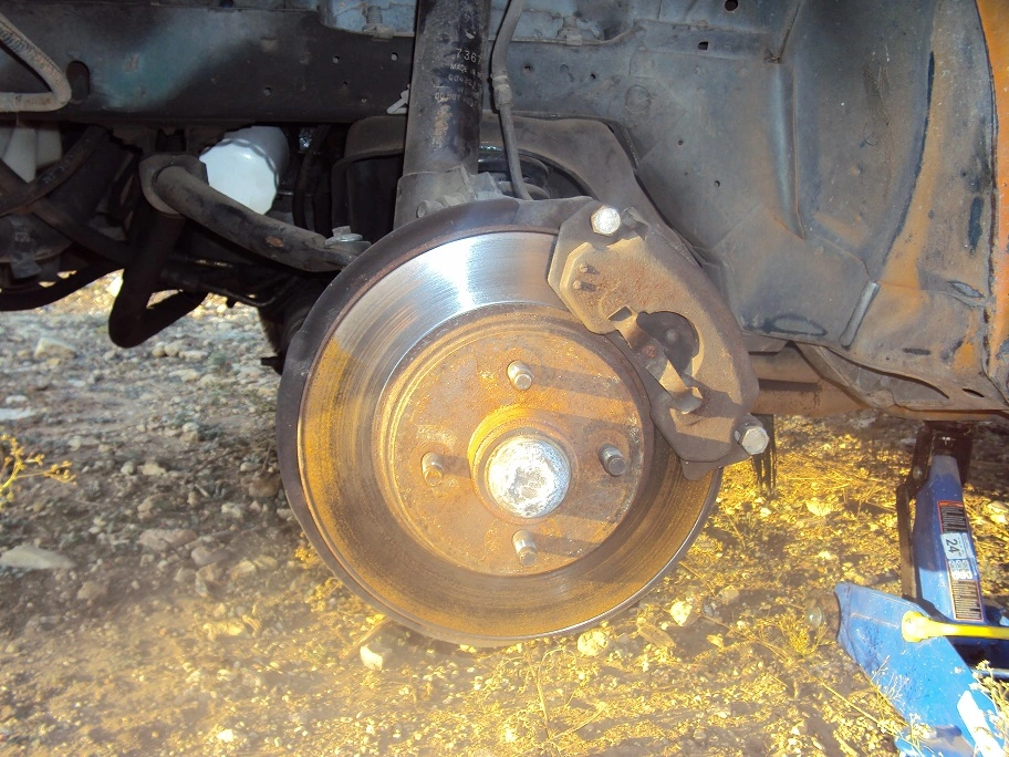

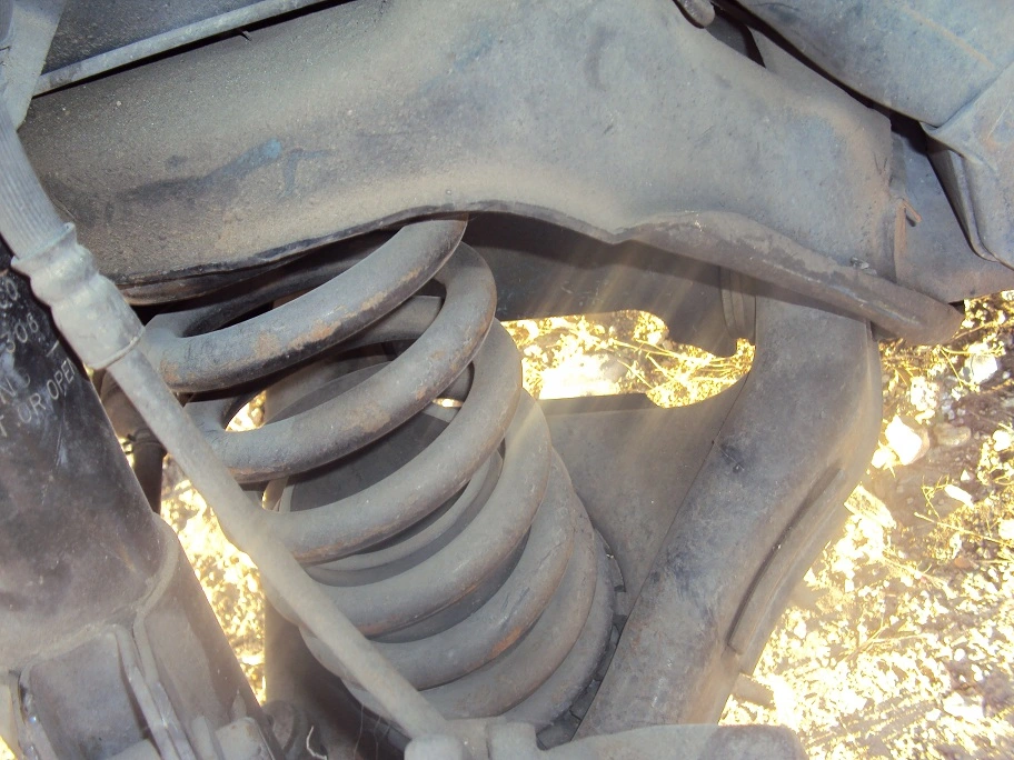

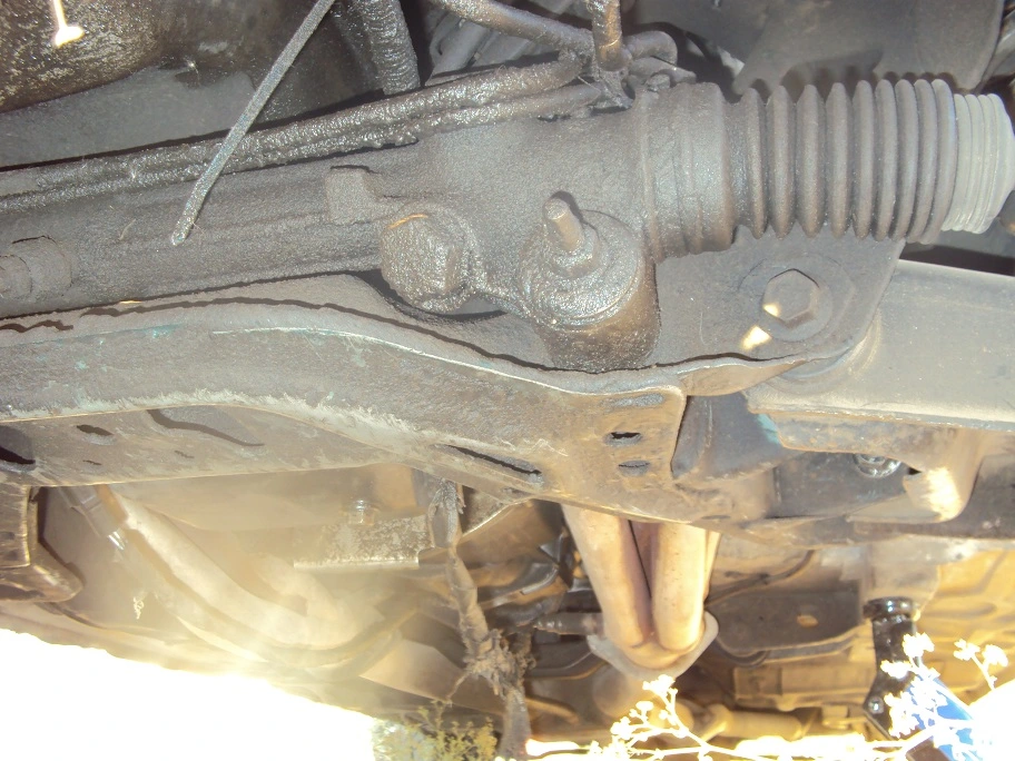

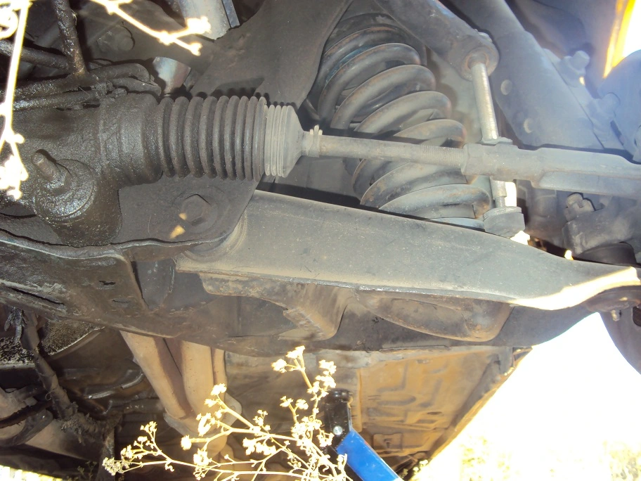

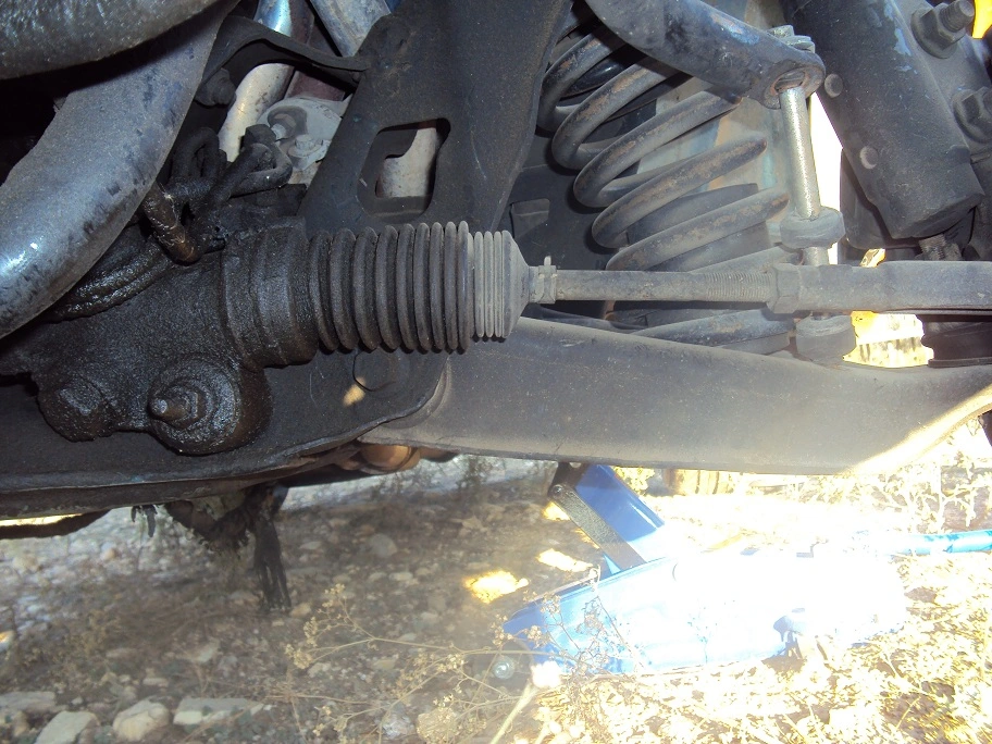

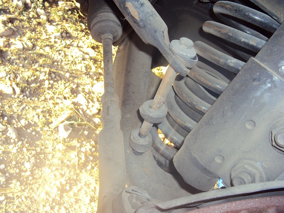

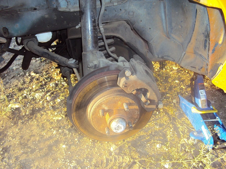

Pictures are in
tell me what you think!

it is pissible the k member is in just a hair off? Not sure if theres any room the way it bolts up though. I dont see anything that stands out other than the oil buildup

so both sides are sitting back a bit?

madspeed said:
it is ****ible the k member is in just a hair off? Not sure if theres any room the way it bolts up though. I dont see anything that stands out other than the oil buildup
Lolololol. If it were just a 'hair' I don't think it'd be such an issue in drive ability.
Yes...yes there is quite a lot of oil everywhere.
side story: One day in the early months I was screwing with it and turned it off and on frequently. Well I left it to run for 10 minutes while I got a drink and I came back and there was oil on the roof of the hood and on the valve cover. I freaked and shut the car off. I eyed 'everything' over on the top end and nothing showed to be what sprayed. I had a friend who's a chevy guy eye it over, not a clue either. And it still runs. So it sprays, drips, leaks, oil everywhere.
Well, I don't think both sides are, again I still have to accurately measure with a friend. but by myself either side 'seemed' equal.
The negative displacement is about 2 inches give or take a few eighths.
