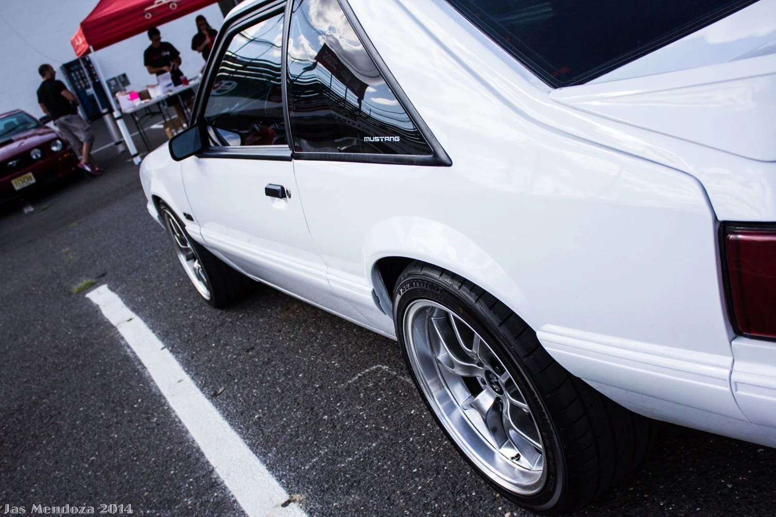

Hey fellas, Been a while since I actually posted a thread!
Still have the car, this July will be 10 years. I need some opinions. I have always toyed with getting another set of rims, Specifically Terminator, or 10th anniversary terminator wheels. They are 17s vs my 18s i have on there now and I just like the look of a fox with those two styled wheels. The bigger reason for this opinion is that my Wife thinks the ride in the fox is rough. Its lowered on steeda springs, and i still have the stock 4cyl struts (but they are still rebounding fine). Foxes ride rough, i really dont think there is anything i can do about that. I can put a new stock strut in, or even upgrade the strut, and go to a smaller diameter wheel with a bigger sidewall tire. But that will only marginally increase the ride over large bumpy roads. You can avoid potholes all you want, occasionally one sneaks up on you and thats why shes made the comment on seeing if i can get it to ride a little better.
What say you guys?? Here's a pic of the car currently.
I like the wheels that are on it. But a 17 will cushion the road better than an 18.

I like the ones that are on it, but I think 17" is a more proportioned wheel to the fox chassis. I'd go with the 10th anniversary wheels

Keep your wheels, the car looks good with them. Foxes don't have to ride rough but they do require a matching set of struts / springs / shocks for a better ride, and handling. Coil overs aren't necessary, just get quality parts that have matching specifications. MM is a great place to get what you need.
