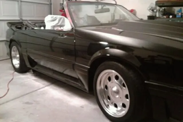

I love my wheels they look good and there old but you hardly see them on mustangs....There centerline 16 woould prefer like 17s..the best thing is that it covers the bolts the bad i cant show of my rear sbcc disc conversion...sorry not a good angle but these are all we got
