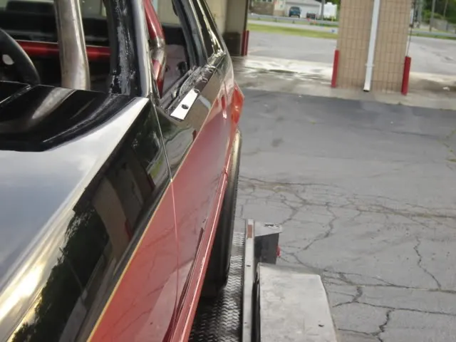

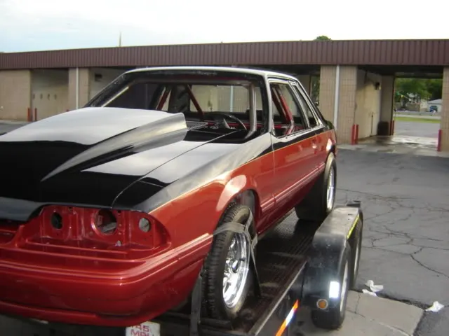

Yes they will fit but look into it first. Make sure they're 15x10 with6.5 back spacing. Thats what mine are with 28x10.5 et drags. But also I had to do alittle massaging to the inner fender it clears now but it was a waste in my case cause now it's getting mini-tubbed... oh well heres a couple pics
