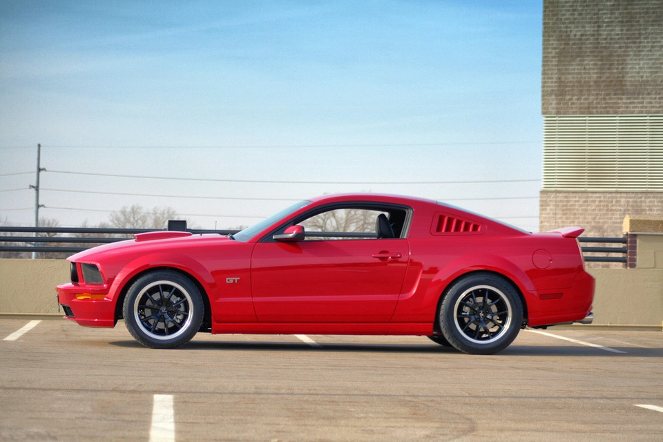

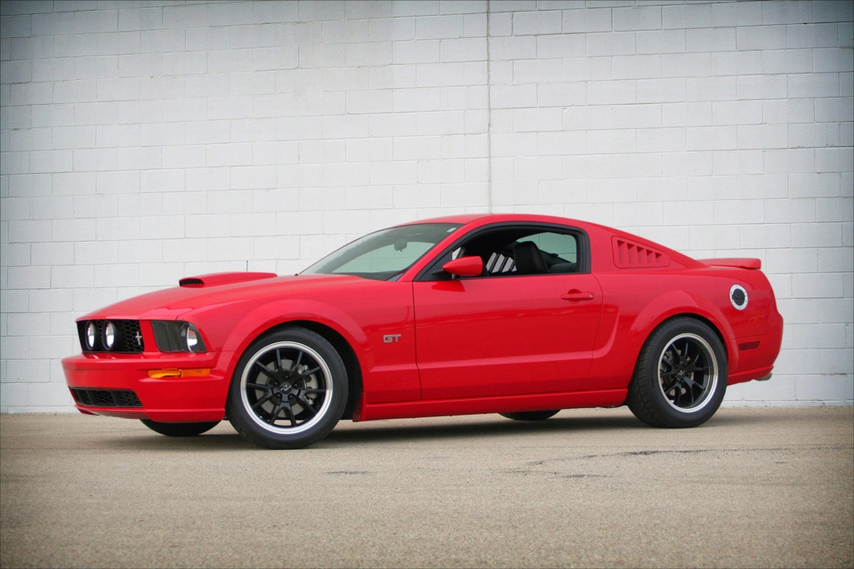

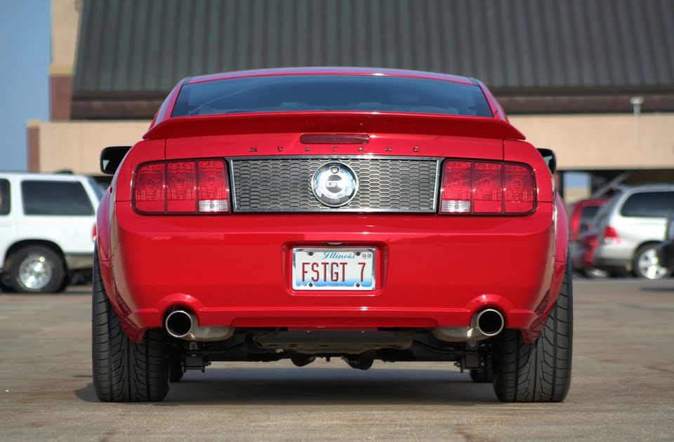

I wouldn't go with that much of a difference. 1 inch is quite noticeable. 2 inches would be too much for sure. Instead of doing 2 different wheel diameters, have you considered just a meatier tire out back? I'm running 18x9 front and 18x10 rear. On the front I have 255/45/18 (about as close to stock height as you can get), and 295/45/18 rear. The rear DEFINITELY looks meaty.

Ahh, no I hadn't even thought about that...and that's definitely more the look I'm trying to achieve too, thanks for uploading the pics. That's a sharp ride DarkFire thanks for the advice!
