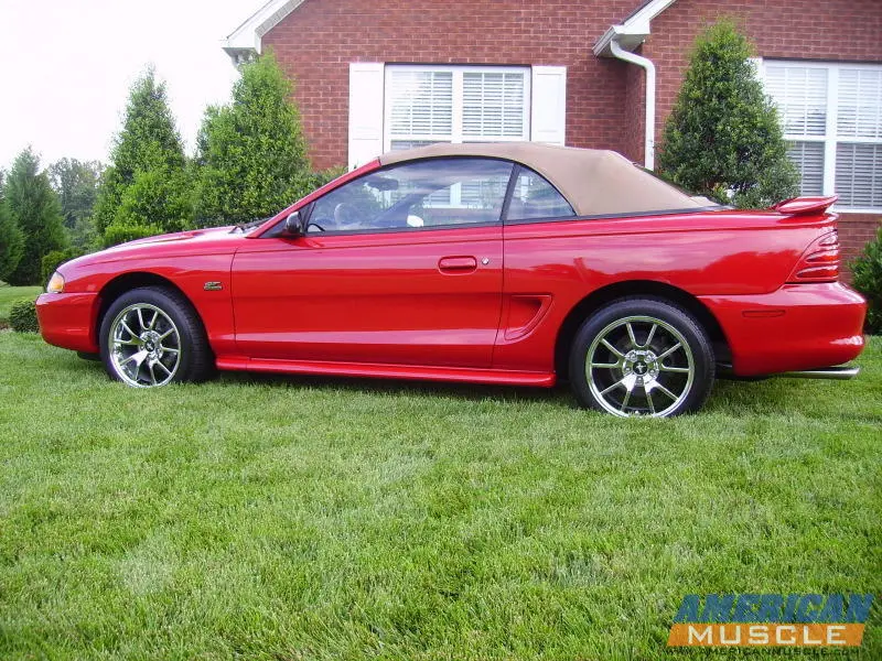

But check this out, I went to American Muscle to check out the FR500s on Stroker's recommendation and this is the first picture I saw. Is it a sign? Amazing. Saved me time in photoshop. You're right Stroker, they're sweet. I'm gonna photshop the Bullitts on to my ride next. I'm still wide open so keep the suggestions coming! On the subject of rotating tires on the staggered set up: It's something I'm still thinking about. In the end, vanity might win that battle... after all I'm already giving up the 18's ;)

those FR's in the pic aren't even deep-dish.....deep dish look so much better... I like the painted rims better than the chrome because the polished lip stands out & gives the wheels a nicer look IMO. & chrome requires more maintinence/care if I remember correctly. just my .02

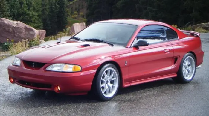

Dude. I am officially torn. Check out this customer pic. Looks amazing with the red... and it's not even sunny out.

I love my FRs, but am not a big fan of chrome ones. They have too many angles for chrome to really stand out. I was thinking about doing black chrome, but if your set on 17s, then thats out of the question.
