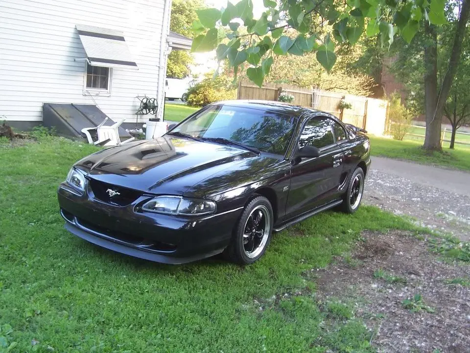

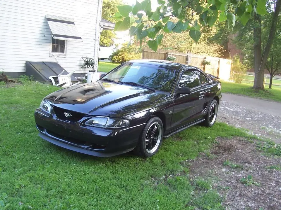

i have 1 1/4 inch spacers on 275's from some guy on ebay, but sound the same as the H&R's with the lugs already in them.
Beware of how big of spacer you go, or you'll have to bend the inner lip of your rear fenderwell to not rub. From experience.

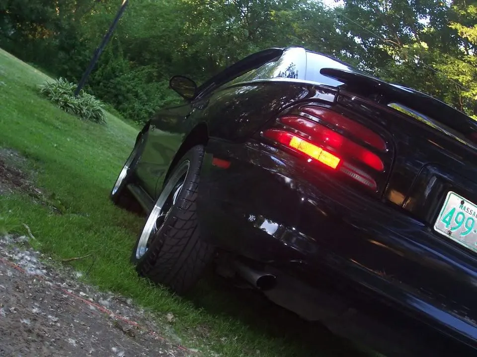

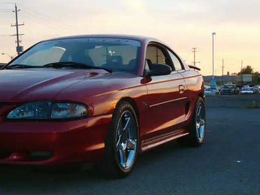

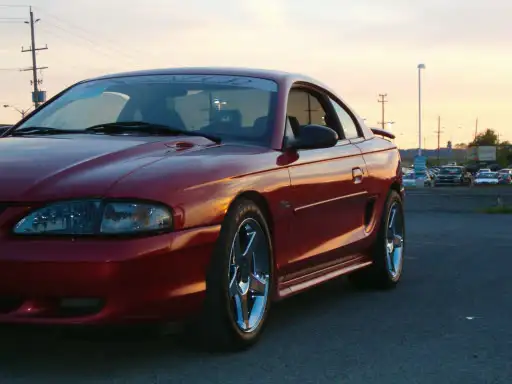

I just put some 1 1/4 wheel spacers on my car today.. I got stock 17x8 bullitts.. Came out pretty damn good actually!

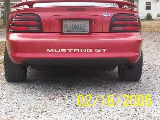

heres a link to the e-bay auction...http://i22.ebayimg.com/01/i/06/4a/48/bf_1.JPG
i have the 1.25 in. spacers and i had to lift the rear on mine a half inch to stop scrubing....

thanks bill, that helps, i havnt seen one like that before with the studs and spacer being one piece before

ya...and there pretty affordable on e-bay but when you install them ensure you torque the spacer to hub bolts properly 95-105 ft. lbs. and i also used loc tight on mine you dont want the spacer coming loose from the hub...
