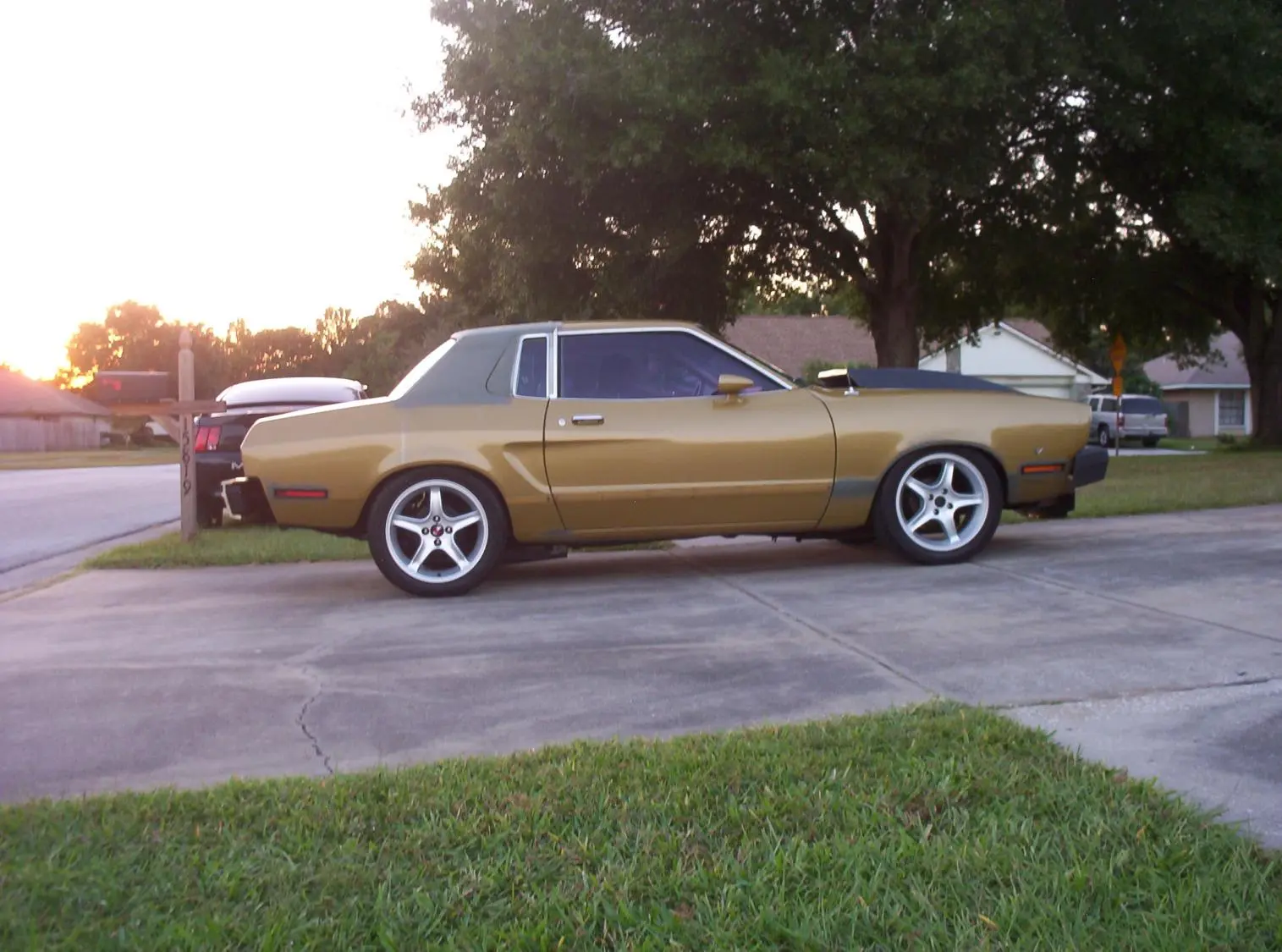

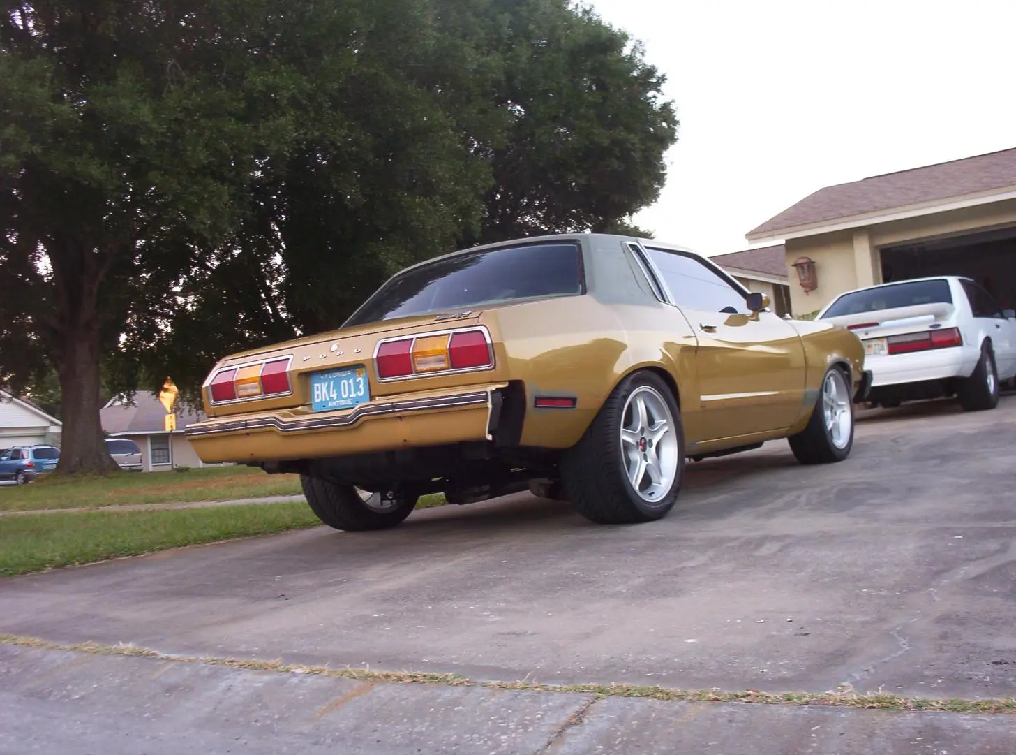

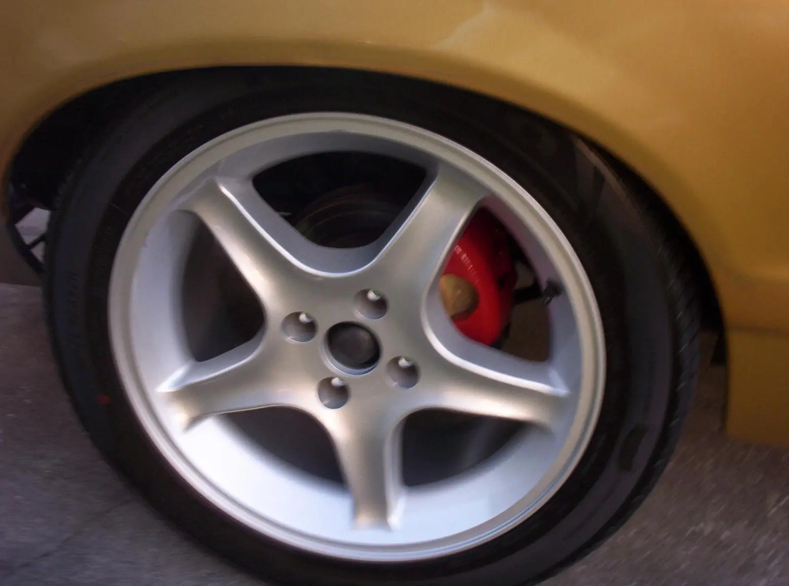

well i finally got to do it due to being lucky in getting some 17x8 and 17x9 cobra R rims from a fox body mustang. the fronts are 17x8 w/4.5 back spacing and bolt right on fine. the rear are 17x9 w/5.5 back spacing and i had to add a 1" spacer and they bolted right on. on all 4 fenders the lips have been rolled. 275x40x17 rears and 245x45x17 up front. and yes i am running the 1" lowering blocks out back and 2000 mustang GT cut coils up front, handles like a slot car now :nice:

You can't put up a post like that without pictures. I think it's against the law...

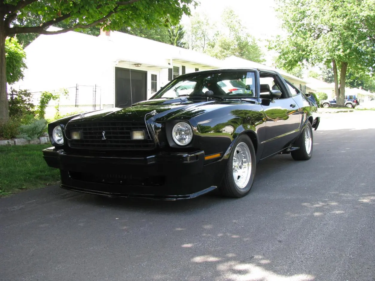

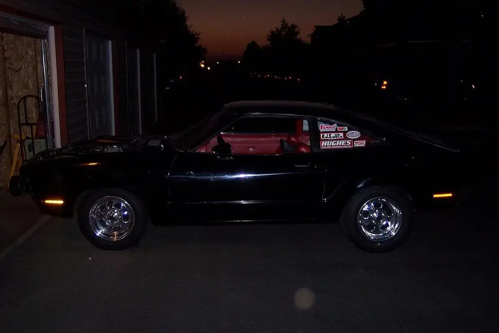

i am running 15x4 up front and would like to go with a wider wheel. i have 15 x 7 on the back but they did not even come close to fitting up front. my king is lowered 2" in the front and 1" in the back.

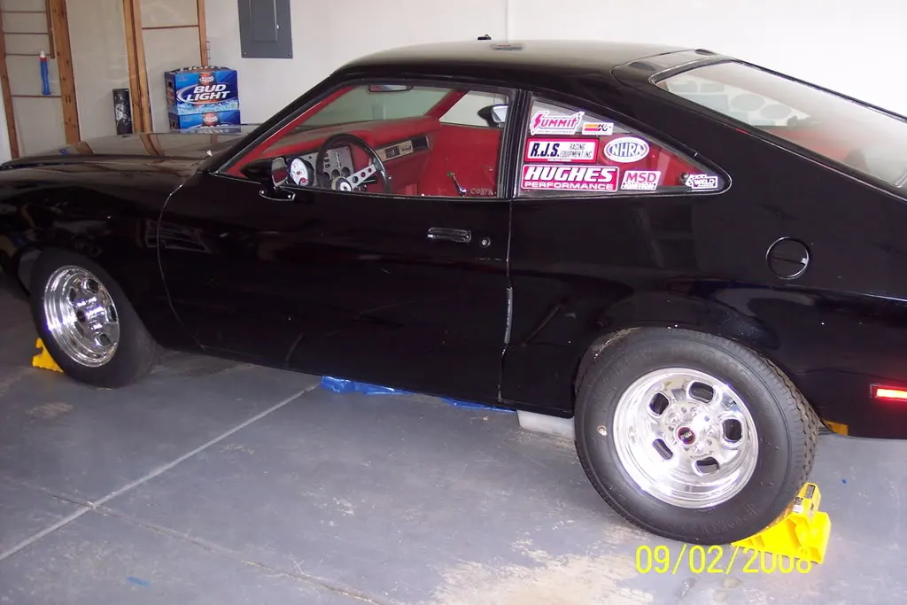

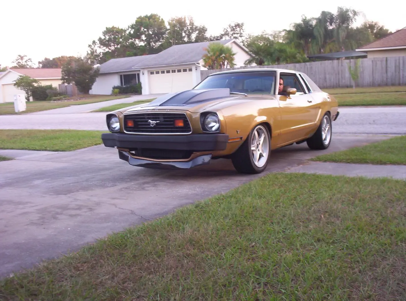

ok here are the pics
ok i'm going to try and post some pics
Reactions: Manoah
agree with needing the pics.
I can't even imagine driving a King Cobra with a 2" drop in the front. Doesn't that mean you catch your airdam if you drive over a dime?? Even with the standard ride height, I take every driveway and approach at as much of an angle as I can, and as slow as possible. Yes, overcautious, but...
it does require some careful driving. my driveway has a pretty good uphill pitch from the road and it takes a few minutes to get the car in and out without hitting the airdam. one of the problems i have had is when turning and the spring goes into compression the tire will hit the airdam where it wraps into the wheel well. i quickly learned how to drive, so it doesn't happen but thats why i always question wider tires on the front of lowered cars. i just can't seem to come up with something that doesn't hit when turning unless i go to a shorter tire.
i drop the rear an inch and that has seemed to help some.

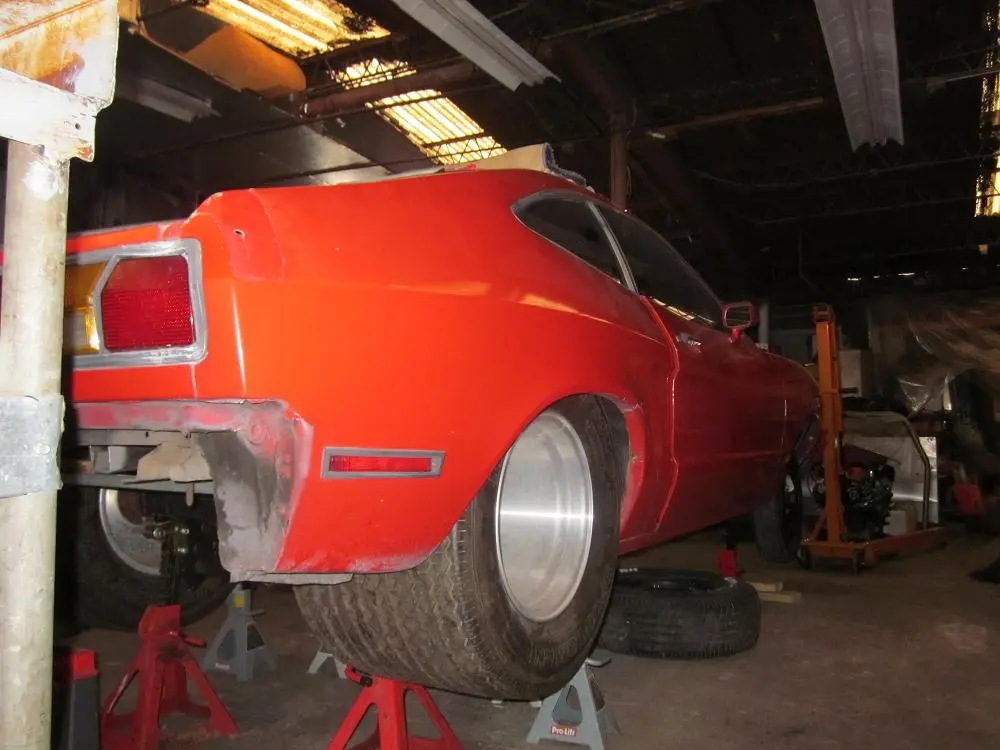

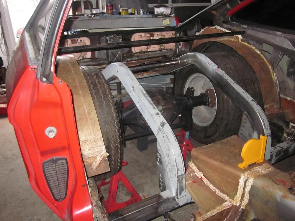

On my 78 Cobra I am running the 225 50 15 on the front on 15 x 8.5 rims but it had it's share of problems but have located a set of 14 x 6 5 bolt slots that will get fit with 225 or 235 60 14's after the restore, now comes the fun part the rears are on a 10 x 15 deep slot sporting 295 50 15's and yes they fit, had to build fender flares to keep it legal as I disliked the idea of mudflaps and with that setup i find it launches quite nicely
