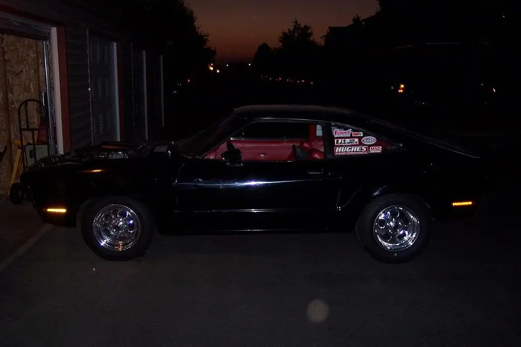

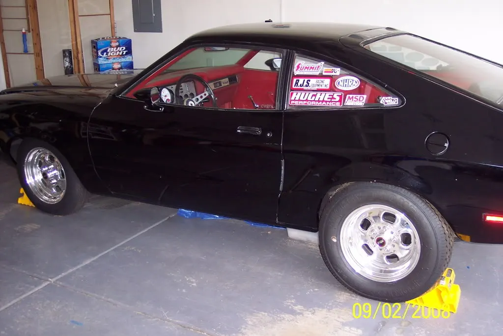

14x7 rim 4 inch backspacing, 26x9.5-14 tire this is only for the rear
attachment.php
attachment.php
I see everyone posts they use a 26 or 26.2. Is trying to fit a 27 totally outa the question. Also with 5/8 narrower tubular uppers what backspace u think I could get on a 15x7 bassett steel rim for up front

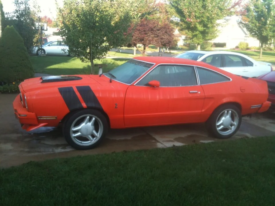

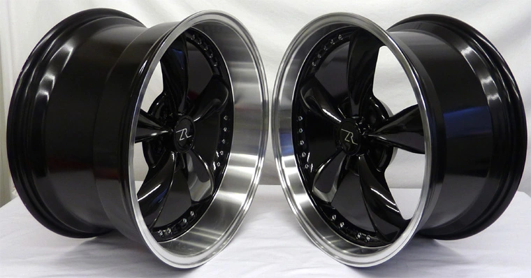

well i finally got to do it due to being lucky in getting some 17x8 and 17x9 cobra R rims from a fox body mustang. the fronts are 17x8 w/4.5 back spacing and bolt right on fine. the rear are 17x9 w/5.5 back spacing and i had to add a 1" spacer and they bolted right on. on all 4 fenders the lips have been rolled. 275x40x17 rears and 245x45x17 up front. and yes i am running the 1" lowering blocks out back and 2000 mustang GT cut coils up front, handles like a slot car now :nice:

I'm running the 17x9 '95 GT split three spokes front w/245/40/17 and 17x9.5" Cobra R rear w/275/40/17.. rear quarters are fully trimmed/rolled. No rub front or back.
For those looking for max meat out back: a simple, cheap swap to the bolt in '67-'70 8" rear housing, have the axles redrlled for 5-lug if needed, gets you 1 1/8" of backspace with out spacers on rear and gets you closer to more "modern" offsets/backspacings.
