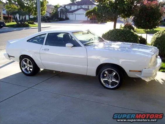

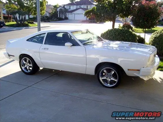

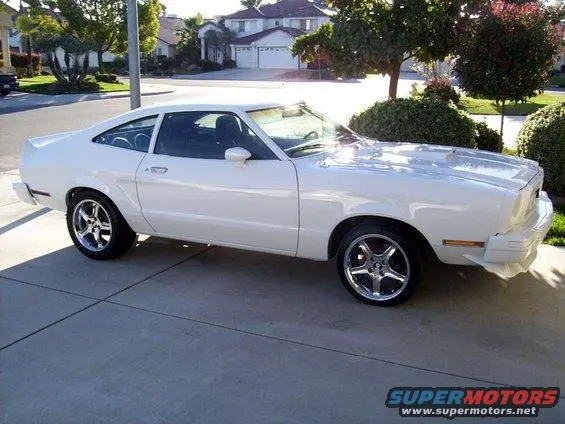

These don't fit very well :rlaugh: 255/50/17's on 17X9's They touch if you look at the car too hard. Just put them on to see what it would look like.

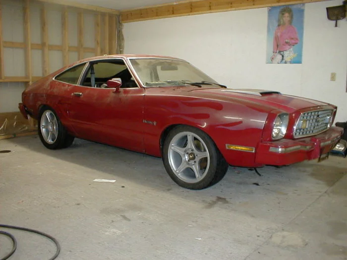

255/45/17 front 274/40/17 rear. spacers on rear and the granada brake swap on the front. Rear fender lips are removed but there is room for a little more. 17X8 GT wheels.
