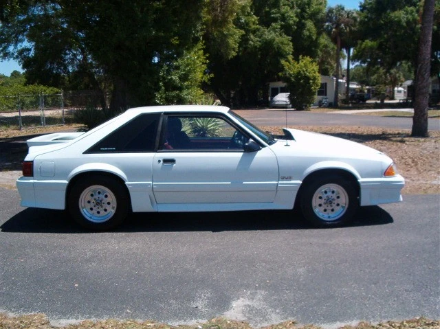

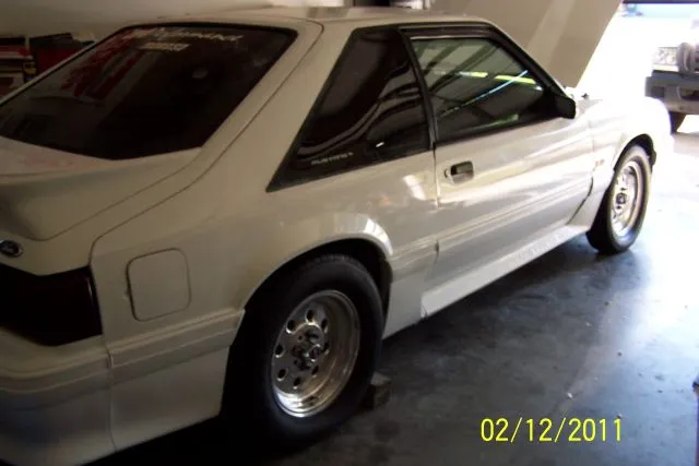

pictures of my 1987 that came with the Weld Draglites on it. I am looking to have a similar look on my
1993 coupe.
