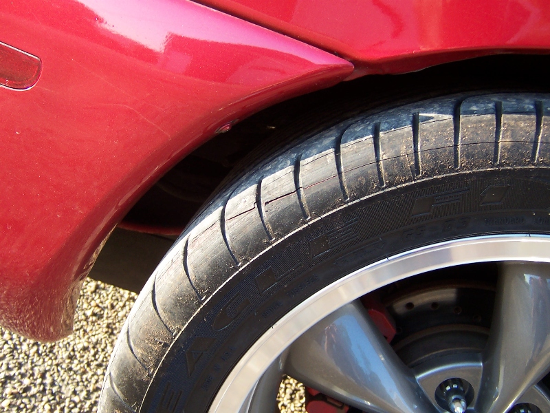

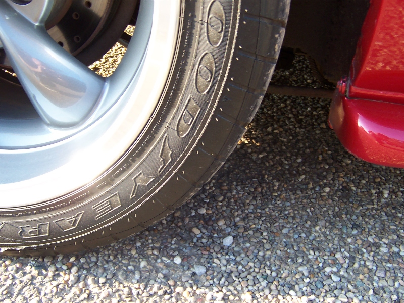

Also, 2" drop and 315's equal cut tire if you're not careful.
