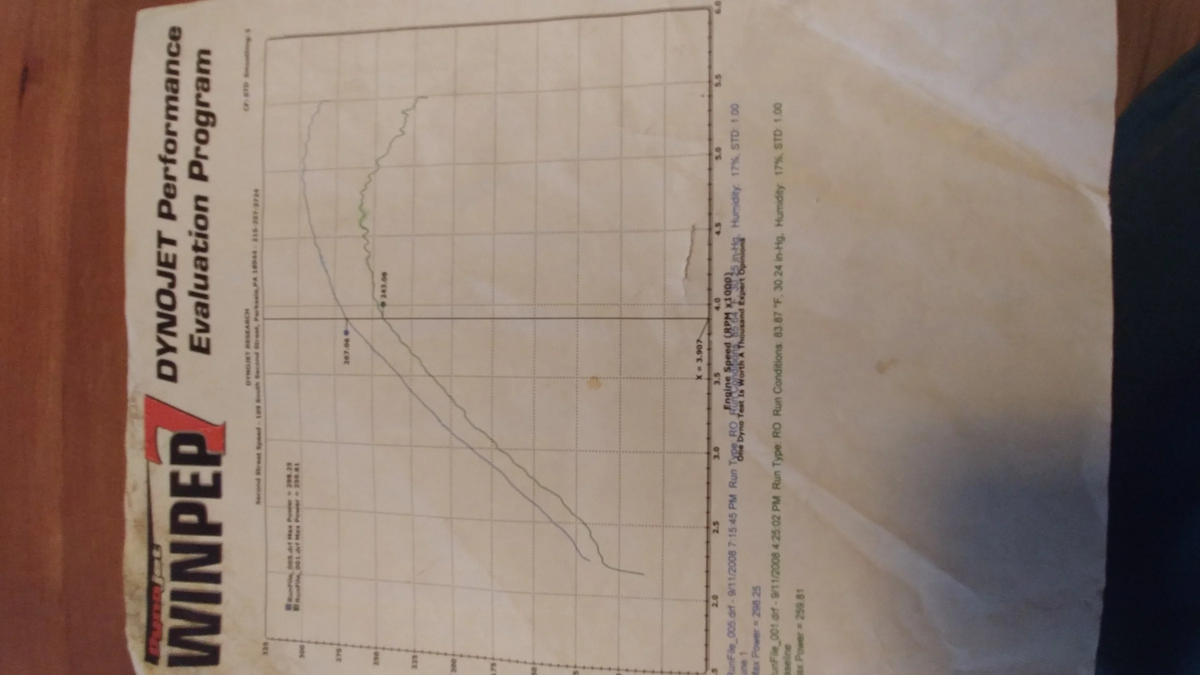

Please post the dyno.

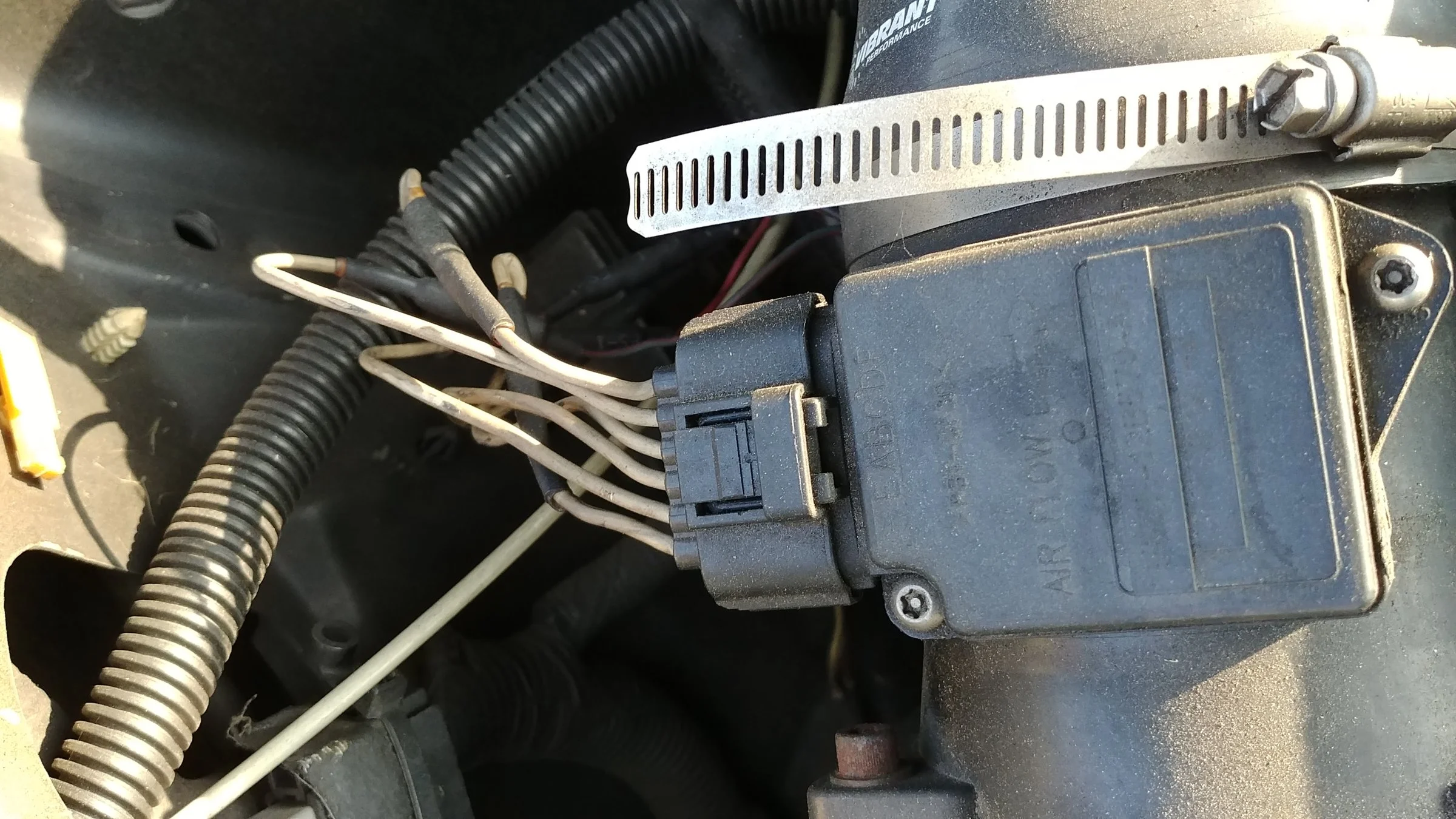

What MAF?

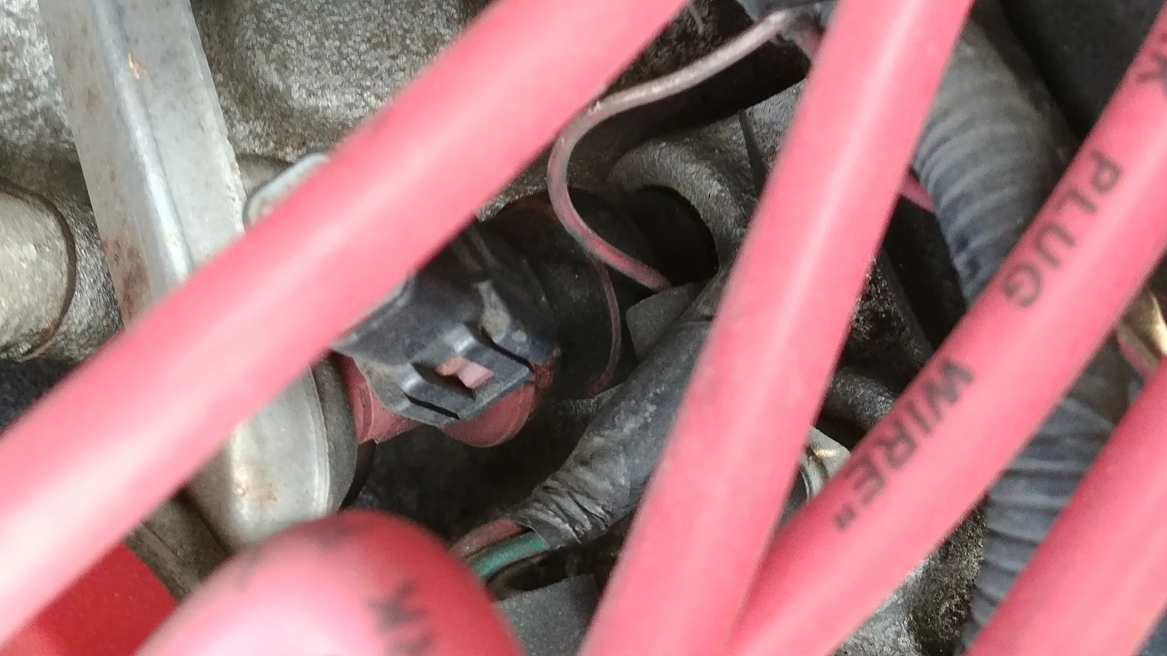

What injectors?

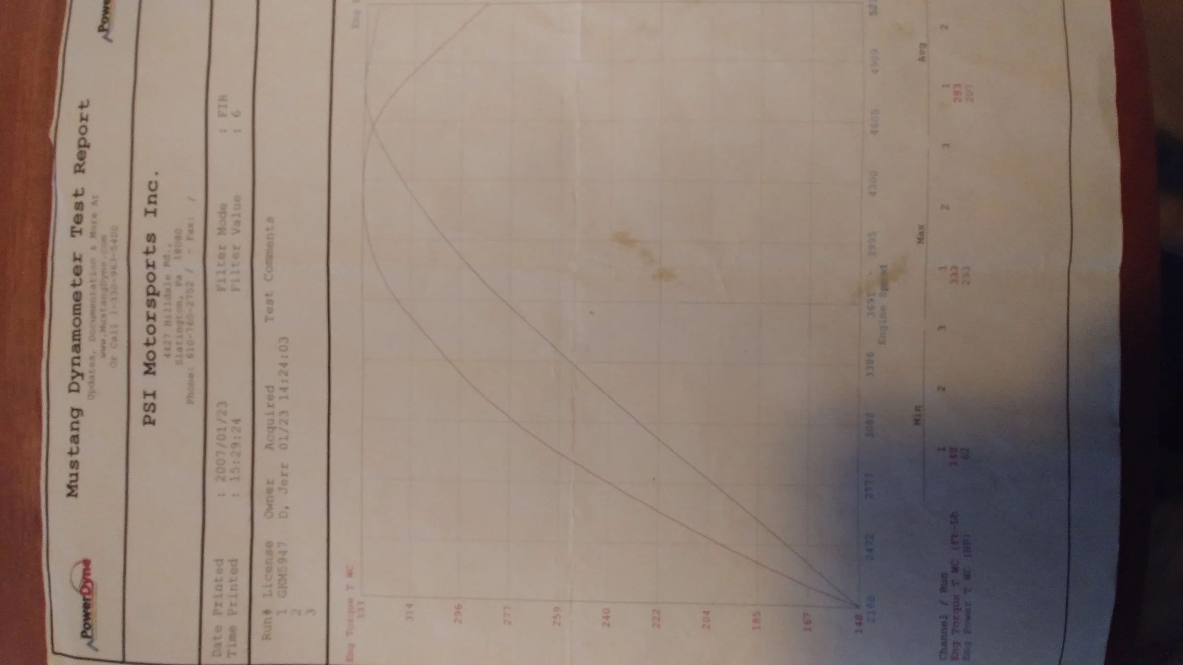

Not sure about any of that stuff. I have dyno sheets they show 300hp and 333lbft. I know I have a lot to learn. I am willing to learn and listen with an open mind. This is also only my second sporty rear wheel drive car. I have always had trucks but before this I had a 1982 Oldsmobile cutlass with a mild small block Chevy.

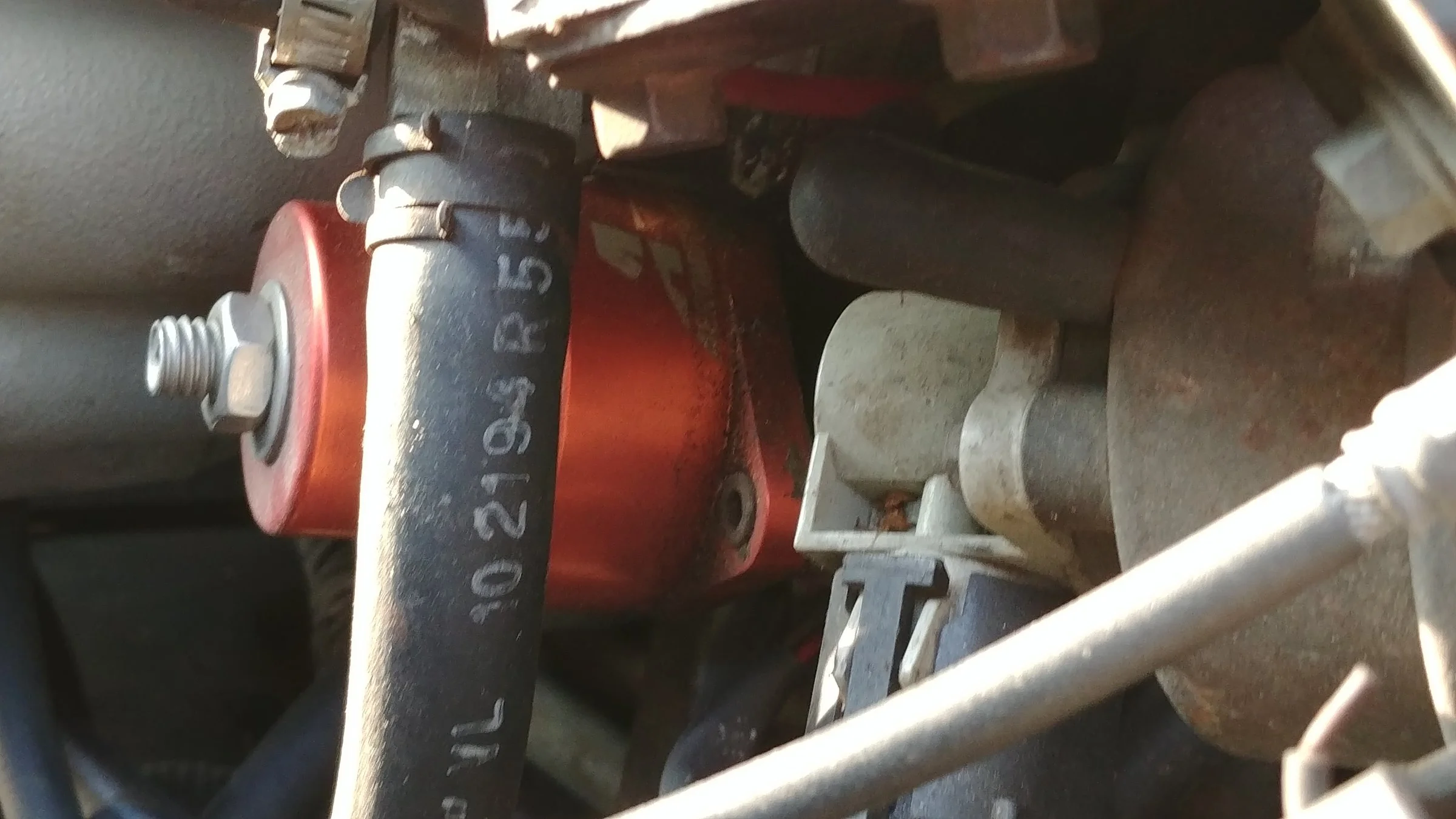

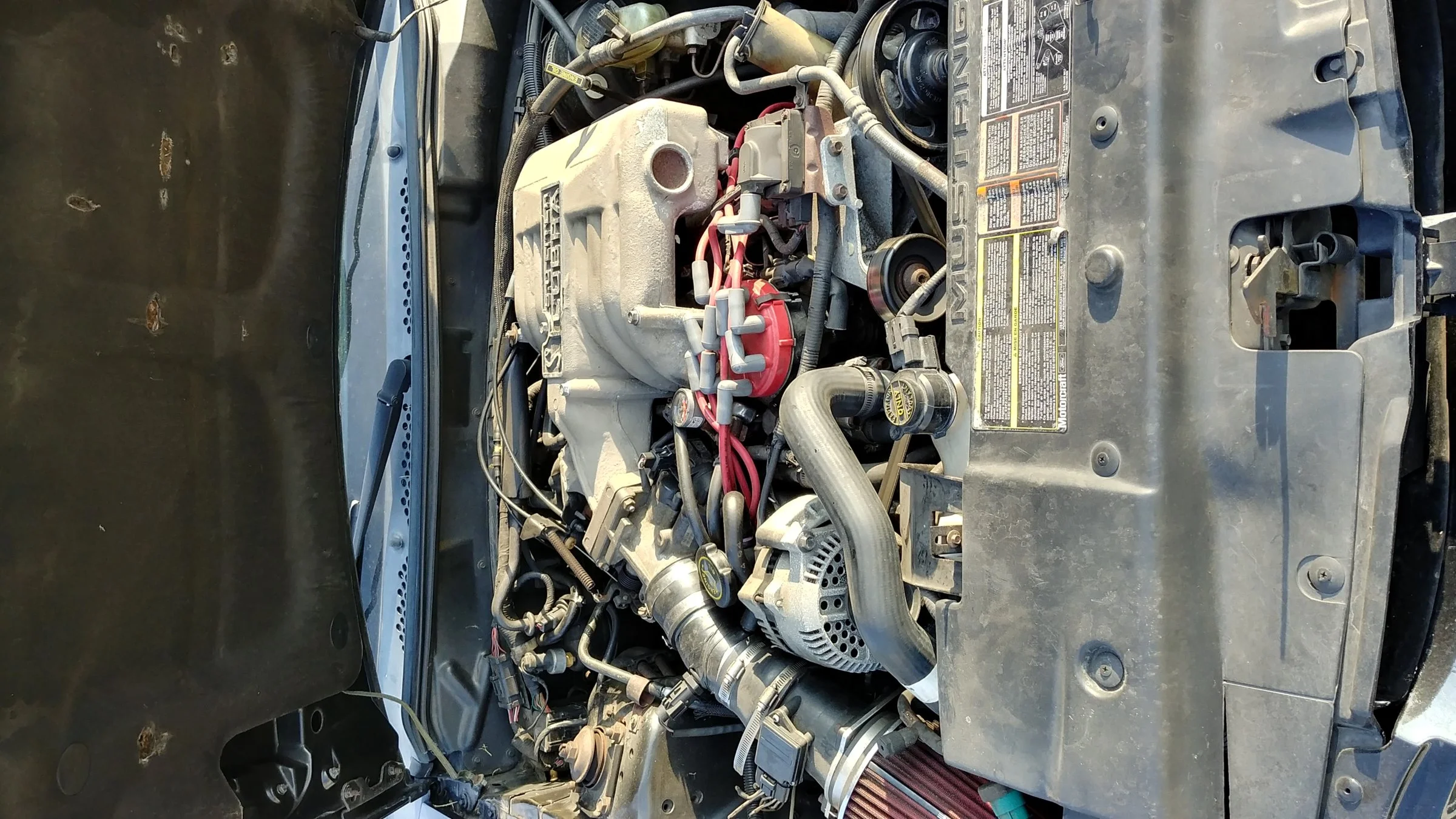

Start taking pictures of everything in your engine bay and post them up alongside any dyno or build sheets.

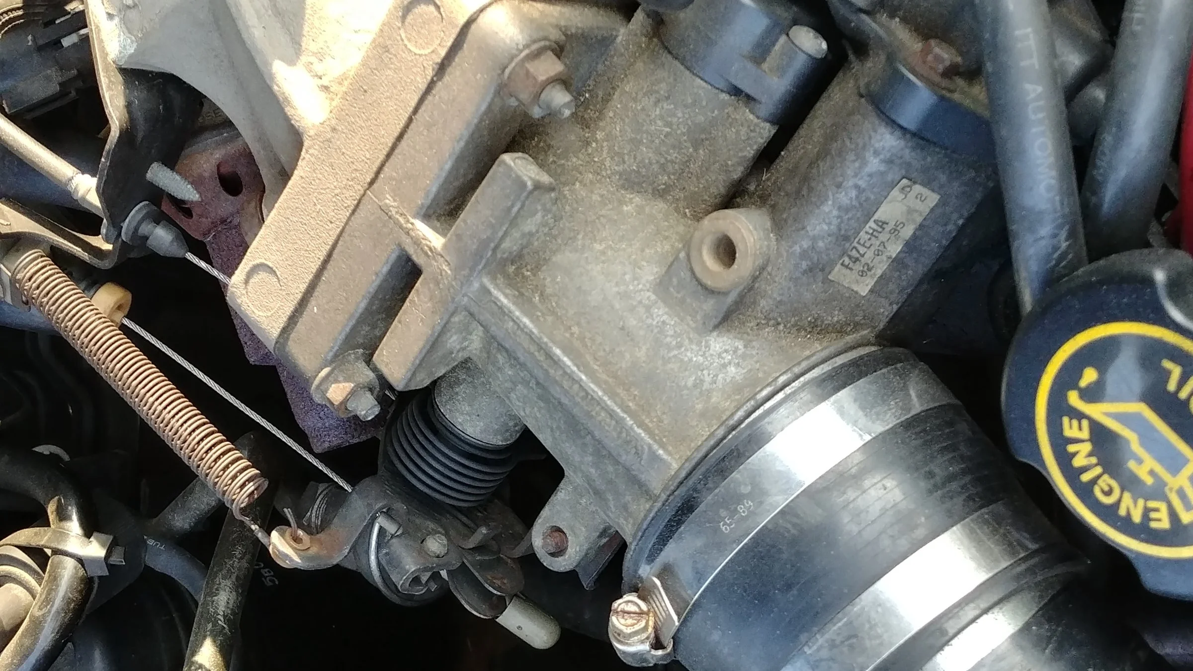

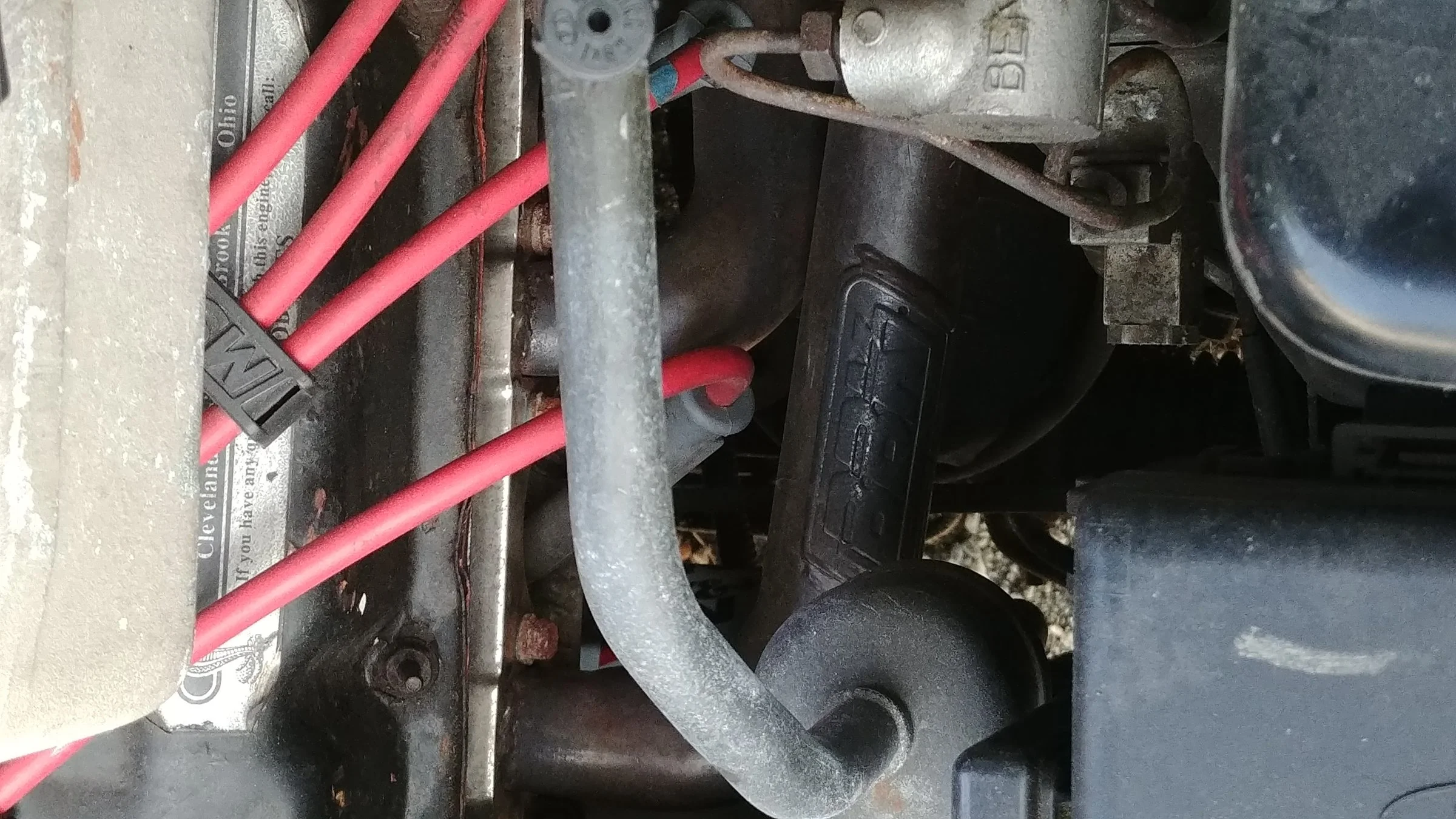

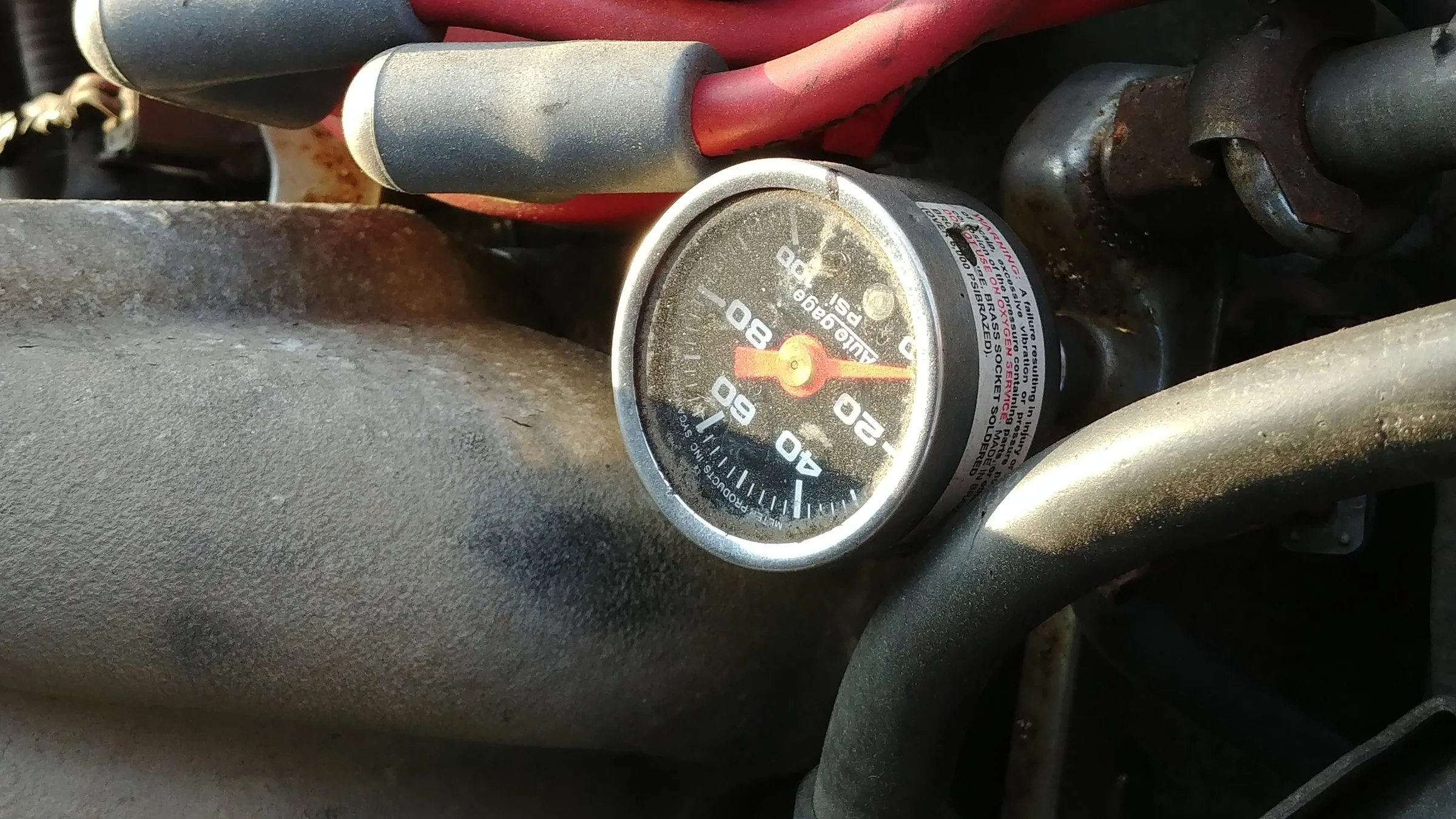

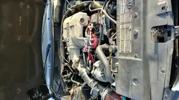

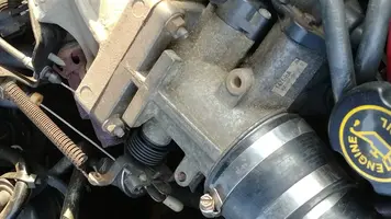

I have no real build sheet I have a ton of receipts. I bought the car from the third owner. I called the phone number on one of the receipts and it was the original owner and he's the one who had all the motor work done.

Red injectors are 30's. You don't need a re-tune just for exhaust changes. It has no affect on AFR.
The car only pulls to about 4700 I was figuring that was because the throttle body and intake are starving the motor on the top end. What is your opinion? It seems like the same thing that happened when I had 305 heads on my 350 Chevy and it was starving because of the small intake runner size it fell off on the top end
Your combo is definitely choked out, but doesn't really need a tune. You could probably pick up a good amount of power by sending that Cobra lower to Tmoss for a port job, installing a 70 or 75mm TB, making sure your fuel pump is up to the task, and installing a more modern cam.

Would the porting and TB mods require a MAFS change or recalibration. I'm sure those mods will need tuned. What is the best way to tune this car. The car has some sort of chip with toggle is What the receipt says
