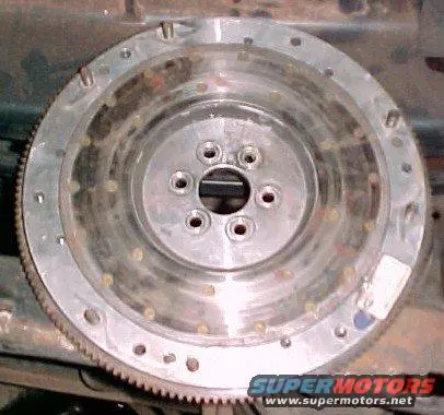

I've got a McLeod I'd sell.
Flywheel is kinda dusty in pic. I can take a better pic without flash if you're interested. I'd like to get $250 for it. I think it has about 75 passes on it. Doesn't have any grooves in it, used a Soft-Loc clutch with it.

I'm assuming that its 157 tooth and 28oz? Also its aluminum right? I run a t-5 so I can't use the other stuff as I like the over drive lol. Also, I'm thinking I'm going to be needing a new clutch soon does that take a 10.5 clutch?
