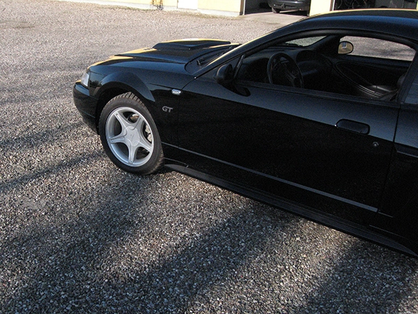

In order to meet strict regulations I have to install side markers on my GT. It's an understatement to say I'm not too excited about this.
I imagine I could take my GT emblems off on the LH/RH side and replace them with amber side markers.
Do you guys know about side markers with a low profile (so they don't stick out too much on the car). Maybe in clear or black glass casing?

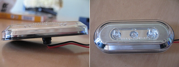

I came across a set of slim LED turn signals. It looks like the plastic piece on the back will fit perfectly into the hole used by the GT badge and with a little doublesided tape they should stick.

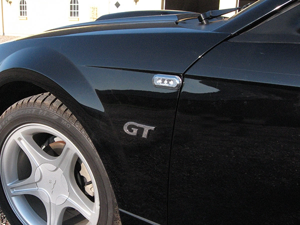

Take off your front wheels and th wheel well liner. There should be one peice of insulation in there towards the door. Remove it and you should have all the access you need to run a wire up to the front turn signals and tap into it. if they are LED, the draw should be negligible.
Good idea to tap into the headlights, that's what I ended up doing.
Using fish tape I was able to run wires from the front turn signals and all the way to the doors through the front fender wiring channels and I didn't have to disassemble anything :nice:.
I decided not to try and pull off my GT badges, because I didn't want to risk ruining the paint. Oh, and then I modified the (1 wattage) turn signals by removing the small raised plastic piece, so they were flush and I could position them anywhere.
