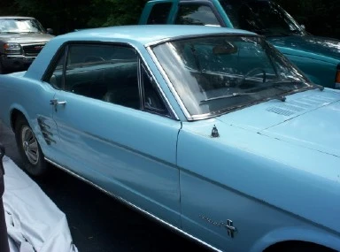

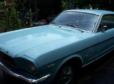

I don't want anything fancy, or special,,,just something to drive around in on a regular basis. I'm sure after I finish it mechanically, I'll have it painted by a good body shop. There isn't alot of rust,,,although there was some damage to the front right quarter at one time (I can tell under the hood that the inner fender well is bent up a bit, also the right door has a gap at the bottom that you can see clear through to the outside).

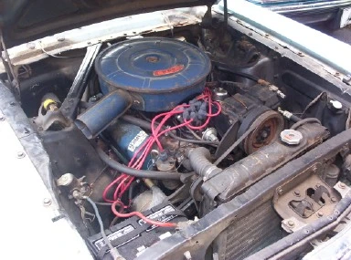

Here are some pics that you guys were asking about...

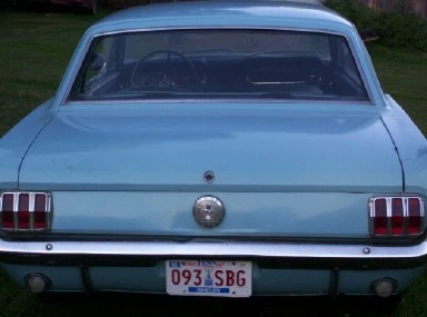

Here are a couple of more pics....it was repainted a light blue color...but it was originally a "brittany blue" color...this was a 1967 color...even though it's a 1966, i guess they started using the 1967 color before the 1967 year. I'm not sure what color brittany blue is...i don't know that I've seen it before.
