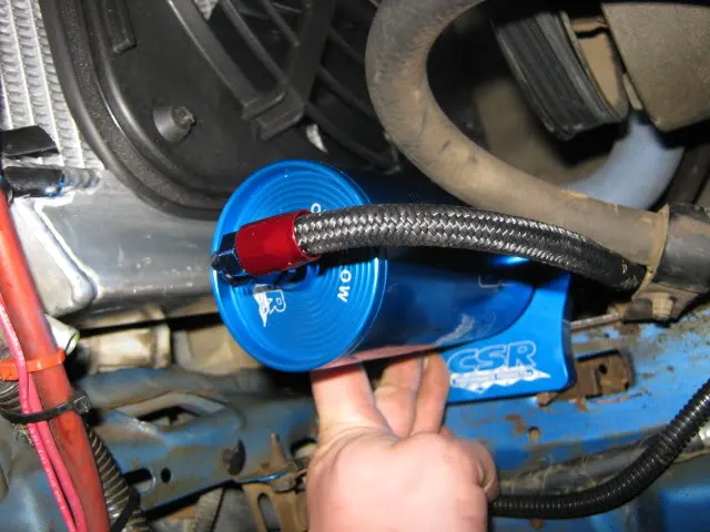

I'm running my outlet to a small length of hose, about the length of the bottle and down to a clamp on the side of the inner fender, kinda under where the battery used to be
