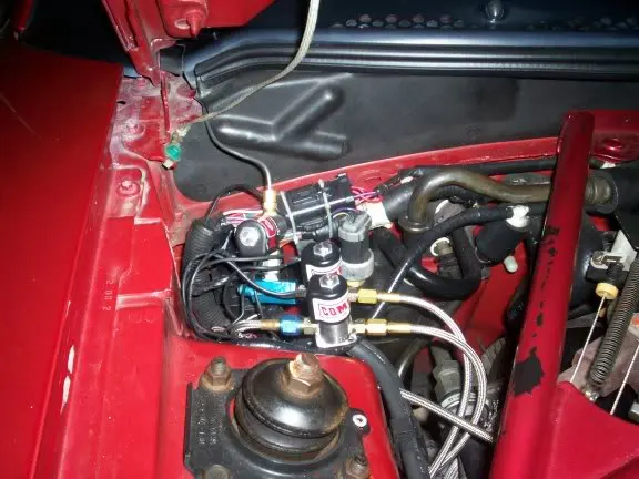

heres a picture of mine...

I've also never known there to be a bracket...
Rick

Bill - I cant tell. Is yours in the bracket? I forgot to look for the bracket earlier.

Mine is more to the left. It is actually attached to the AC drier. I am off work tomorrow and I am going to find the other end and change my intake gaskets. I need to fix the oil leak bad.
yes it is...
