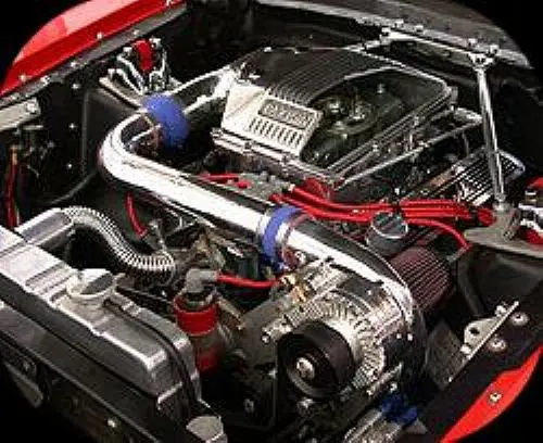

Paxton makes a kit for carbed motors. It is for the early Mustangs, but I am sure you could adapt it with a little work, or with mixiing some of the EFI mount and carb parts.
http://www.paxtonauto.com/catalog/systems.asp?Action=GetPart&Part=1001840
This is the route I will go with mine next Winter. It uses a full carb enclosure, so there is none of the problems that the early blow through systems had under high boost.

Are you going to run 10-12 psi through one of those hats? Not me. If you only want 6-8 psi of boost, they are fine, but total junk for high boost applications.
Anything over 8 psi with a hat, and you are sure to have regular carb problems, even if using special floats.
