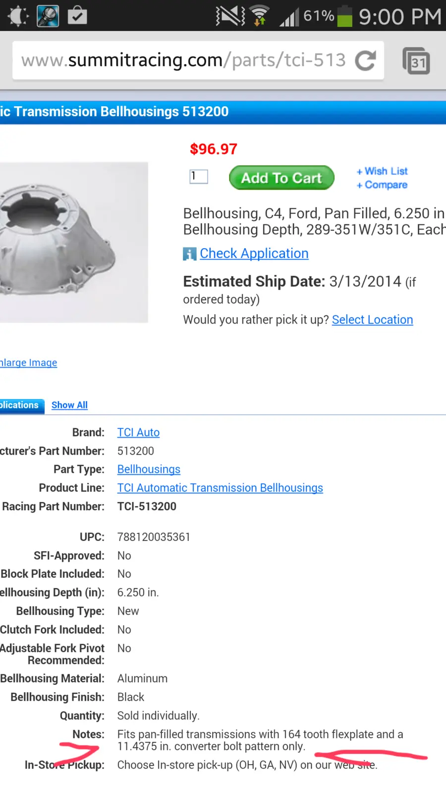

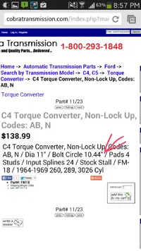

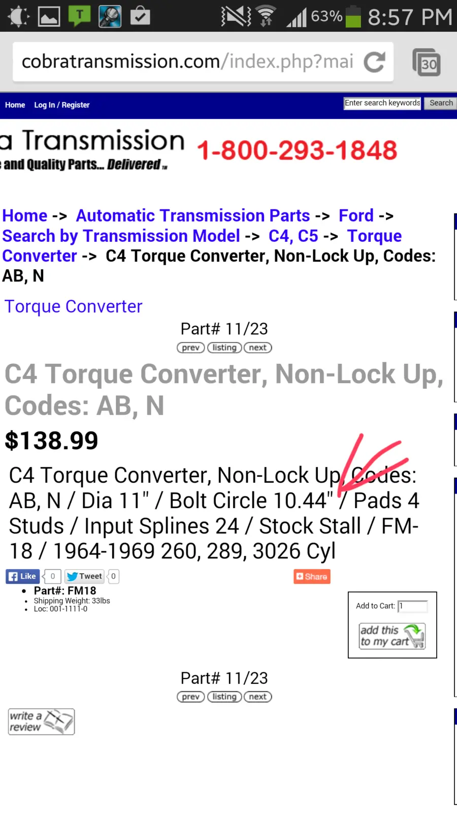

B Braden65 Member Jan 14, 2014 70 0 7 Mar 5, 2014 #1 Mar 5, 2014 #1 I Have a 65 289. Put the 289 in an ex straight 6. Any ideas where to get a good 24 spline converter and bell housing? The two I found conflict each other with the bolt pattern and i haven't had any luck on craigslist. Any help would be appreciated. Attachments 2014-03-05 20.58.38.webp 74.6 KB · Views: 212 2014-03-05 21.01.40.webp 71.9 KB · Views: 255
rbohm Founding Member Apr 12, 2002 6,698 550 204 tucson,az Mar 6, 2014 #2 Mar 6, 2014 #2 assuming you have a 6 bolt block, here are two bell housings and a torque converter; http://www.summitracing.com/parts/bmm-50412/overview/ http://www.summitracing.com/parts/tci-513300/overview/make/ford http://www.summitracing.com/parts/jpt-92462-157/overview/make/ford the bell housings are for 157 tooth flexplates.
B Braden65 Member Jan 14, 2014 70 0 7 Mar 6, 2014 #3 Mar 6, 2014 #3 rbohm said: assuming you have a 6 bolt block, here are two bell housings and a torque converter; http://www.summitracing.com/parts/bmm-50412/overview/ http://www.summitracing.com/parts/tci-513300/overview/make/ford http://www.summitracing.com/parts/jpt-92462-157/overview/make/ford the bell housings are for 157 tooth flexplates. Click to expand... Thank you. There's no cheap way out of this is there.
rbohm Founding Member Apr 12, 2002 6,698 550 204 tucson,az Mar 6, 2014 #4 Mar 6, 2014 #4 not if you are going to buy new parts.
