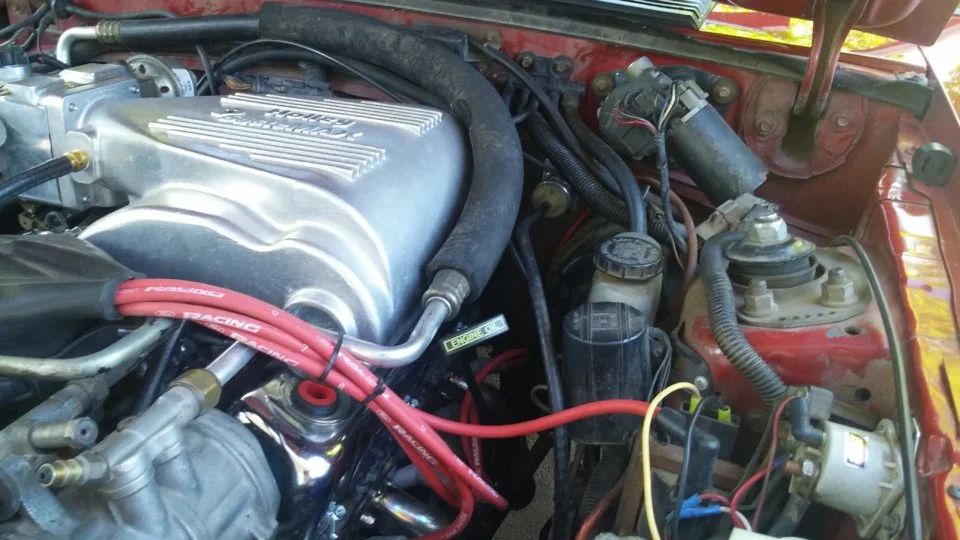

How long have you had it? Post a pic of the engine bay?

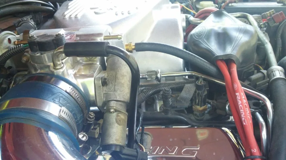

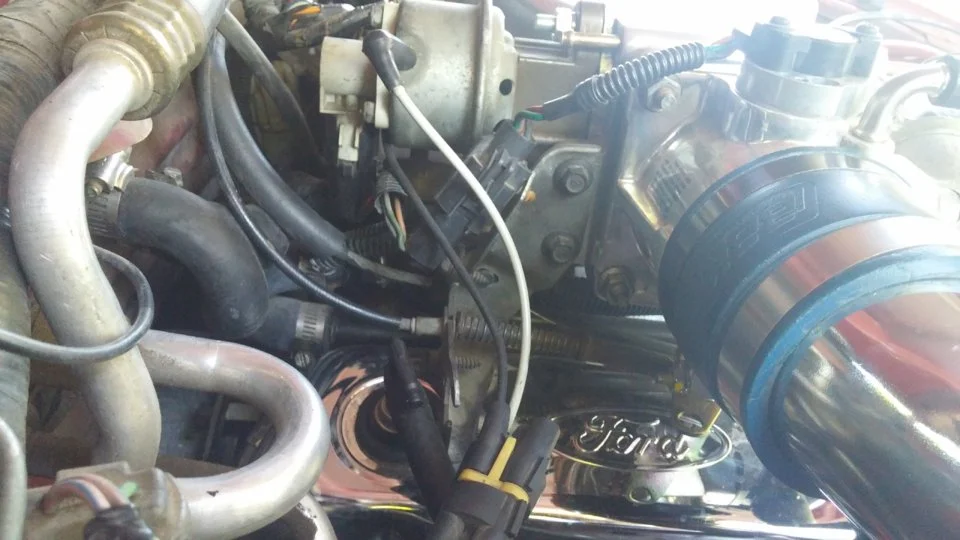

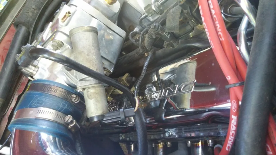

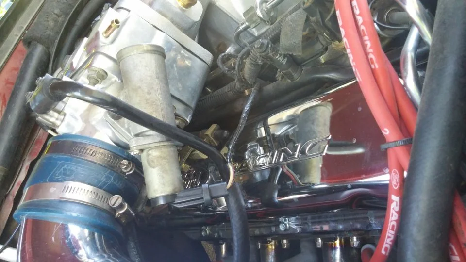

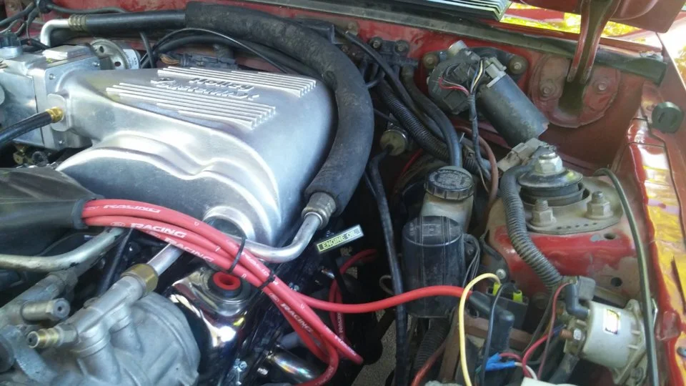

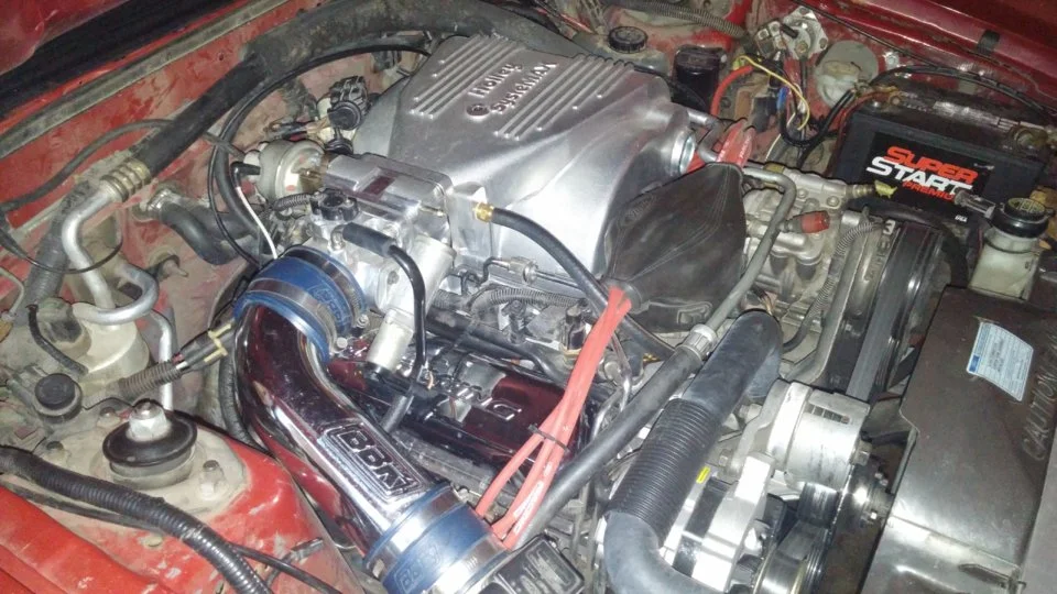

At work and dont have super detailed pics of the bay. But heres what i have
I see a couple things (assuming this picture is current and is how you're running your engine).
1) Where is your oil filler neck?
2) the black hose that connects to the top of your throttle body (TB), right where your blue BBK rubber coupling attaches, is supposed to connect to a barbed fitting on the oil filler neck. It's part of the PCV system. Where does this hose go to? Do you have a PCV valve?
3) There are two missing lines on your EGR spacer, picture is likely not current or else you'd be spitting coolant everywhere.
I'll wait for a current picture before any more input is given.
Ok, then the coolant lines on your heater tube must be blocked off. Do you know if your EGR is functional? If not then you should fix it. If the hot gases are being fed into your EGR spacer then YOU NEED the EGR spacer coolant lines hooked up. The recirculated air from your engine is hotter than your coolant. Without the coolant lines the recirculated air will heat up your incoming air into the engine.
If you have a PCV valve you need that black tube hooked up to the top of your TB from your valve cover (normally hooked up to your oil filler neck). Pressure builds up inside your engine and sometimes oil comes with it and that tube redirects the oil into your intake and into the combustion chamber to be burned off. If you do not have a PCV valve then you need valve cover breathers on each VC directed to a catch can.

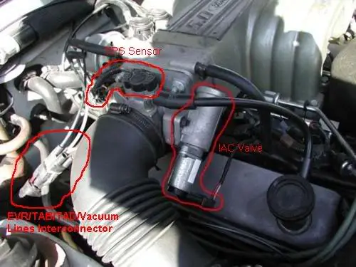

Here is a picture showing the factory way of routing the EGR coolant lines and the valve cover to TB tube. This is a random picture I found on the internet so disregard the red lines.
If your oil filler neck is on the driver side and the neck is closer to the back side of the engine (closer to the firewall) then the P.O. simply installed the VC on the wrong side. I recommend switching them.
