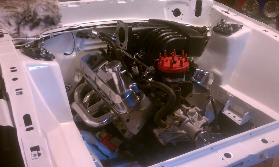

I pretty much agree with @89oem for the most part. I however think you should upgrade the MAF and fuel injectors just because you'll be in that area anyways with the upper intake off when replacing the valve covers. On another note, since the P.O. didn't bother to upgrade the stock MAF and 19# injectors then you likely have a stock fuel pump. You'll want to go ahead and pick up a new 190lph or 255lph puel pump kit to help deliver more fuel.

Yes, it has the barbed fitting in the filler neck. The screw for the baffle they supplied suck. Read my review on the LMR page (you'll see my engine pic) and you'll see the remedy.
