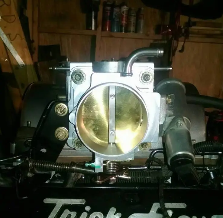

OK...I looked at your pics...I have the exact same throttle body and no holes in the butterfly ( problem #1 ) Did you adjust the TPS sensor ? Do you have a tune for those injectors or are you running a pre-calibrated maf ?
Its a pro m 75mm cal for 24lb injectors. Stock computer. Tps is ok. Surges still horribly and running super rich!

I've seen people drill holes in the butterflies to try to solve idle issues...not a good idea...it throws off what the computer expects to see from the TPS and the idle air control valve. If you have a fender mounted cold air intake you can try rotating the maf sensor. Also check the o2 sensor wires running in front of the rack and pinion....mine grounded out to the subframe once causing rich symptoms and surging idle.
