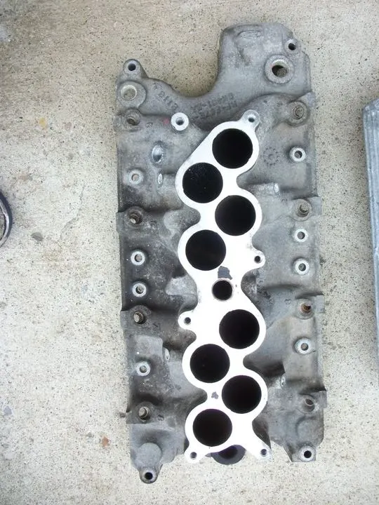

thats what i figured it sounded absurd . I tried it in thermostat housing but the sensor is too long. where is the extra port on the lower intake manifold. I am running gt40. thanks

The factory Mustang intake has two threaded ports on the rear of the intake. One is used for the coolant hose that goes to the EGR spacer. The other one is on the driver side rear and is plugged off from the factory. I used that one. But when I changed to the 97' Explorer intake I had to drill and tap a hole in the same place.

are there any ports on the gt 40 one.

NO, see the two flat spots in the casting just in front of the rear bolt holes? You will have to drill and tap one of them for the switch if you cannot use the T'stat housing.
