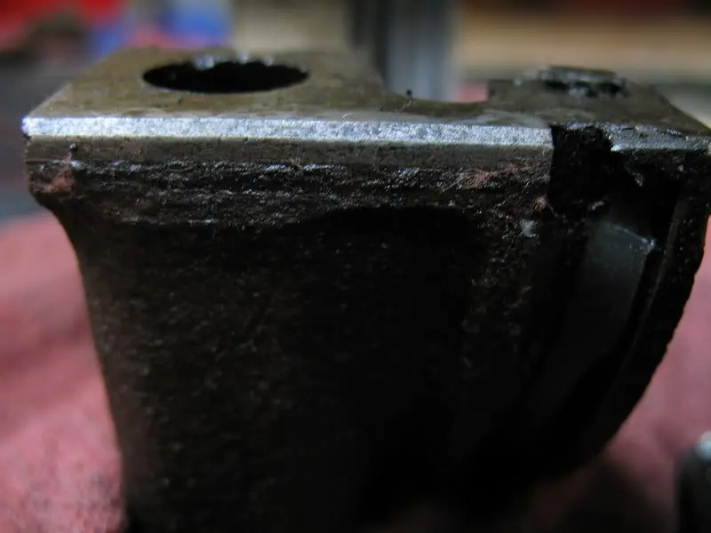

The RTV goes specifically where the main cam meets the block register. Look closely at the ends of the main cap and you will see this bevel (thin shiney line) that goes the whole width of the main cap:
A light little dab will do ya in the block and you only need it toward the rear most area of the block .
Also, I am not fond of using the red high heat stuff on engine internals and prefer using Permatex Ultra Black.
