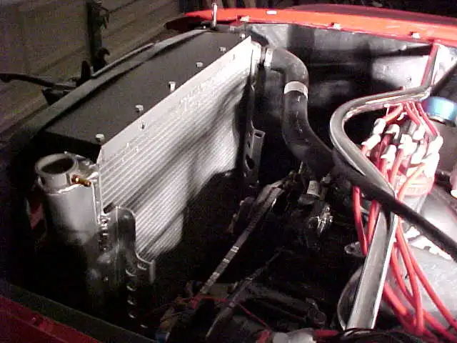

This is a chebbie radiator from a company called "Northern", it is the series they call "race-pro". It was cheap, it is very lightweight too. I mounted it with those little rubbery/spongy spacers you can see on top of it in this picture:
Here's a better picture of the size and fit:

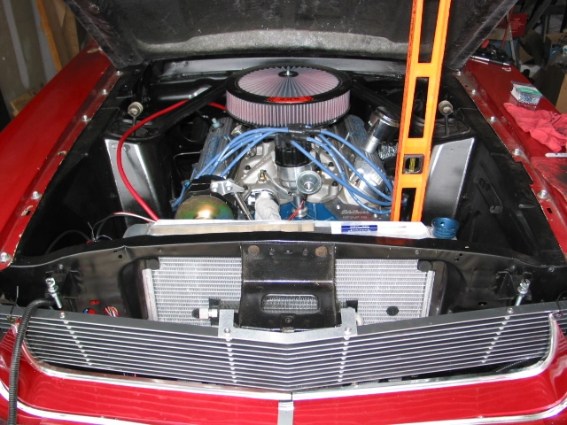

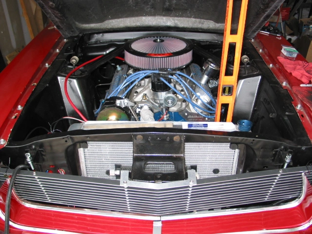

I put an Afco 26x19 universal ford radiator in my 69 stang. Fit is great and brackets were easy. Its a racing 2 core radiator which you would thing would be bad on the street, but it cooled better than a brass 4 core radiator. It was around $180 shipped to my door. I probably spent $20 in materials to mount it and it looks nice.
