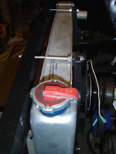

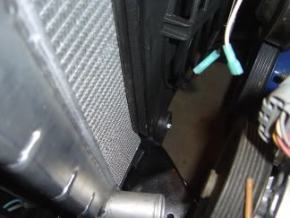

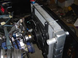

Here you go. The first is of the top connection- http://i48.photobucket.com/albums/f210/68converted/Radiator02.jpg and the second is of how the setup looks from the back- http://i48.photobucket.com/albums/f210/68converted/Radiator01.jpg and lastly the bottom mount (barely visable) http://i48.photobucket.com/albums/f210/68converted/Radiator03.jpg
Hope that helps. I have turned up the fan as a test and it moves a ton of air. I am using an adjustable control, and a 180 deg therm.
Thanks for the pics 68Converted, this is very helpful. Looks like a very solid install. I have a lot more to chew on now from this thread. :D
