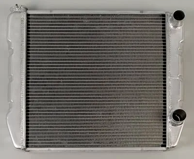

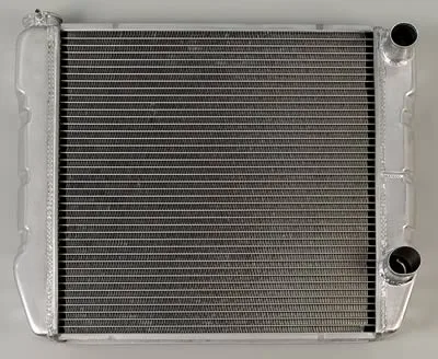

I decided to go with this PWR from Absolute Radiator after doing some more research. Northern makes a model 5137 that The Hot Rod Store sells for $340 + $25 S&H. I called for details and they told me "yes it will fit the 68, but it is not exactly a direct bolt in (contrary to what they advertised on eBay). Would require some light mods to the flange to mount the unit, no big deal and I was prepared to order anyway, until I researched the PWR. Absolute sells it for $375 + S&H, so not much more, however these should require no mods. The quality and reputation seem be very good and it's a polished tank to boot. So I should receive it in a few days and will report back on the fit etc to help anyone else with a 68.
Just thought I would post an update as this fairly simple part becomes a saga and bottleneck in my project! As I said in my last post, I purchased a PWR radiator from Absolute Radiator (very nice and professional staff). I ordered the unit specified on their website for 68-69 Ford Mustang, Small Block, Manual Trans. I received it the other day (nice piece) and did a quick mock-up, it was obvious that this was not going to just bolt in. I called Asbsolute and was told that apparently the radiator I had in my 68 had to be the same spec as the 67 Small Block and apparently some of the early 68 Stangs used leftover 67 parts. My stock (and I believe original) radiator measures a little over 20" wide if my memory serves me. The PWR I received is 24.5" and was not a flange mount like the original. I could have made it work by cutting the radiator support, but that was precisely why I decided to go with the PWR and not the cheaper Northern. So anyway, Absolute is taking care of me and shipping the 67 version, but it will be a few business days before I receive it. Just curious if anyone else is aware of this anomoly with the 68 using leftover 67 sized radiator?

I returned the PWR (refer to latest post in thread), but can tell you it's a 2 row design. Sorry, don't know the spec on thickness or the tube diameter. I told them I was at 400 hp and it wasn't an issue.
