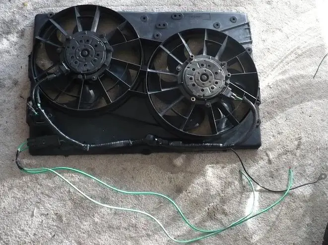

No V6 Contour/Mystique in the junkyards by you? There was at least 15 of them that I saw, 6 of there were V6 engines. There is one bolt that was hard to get too. I got lucky because one had the motor out. It made removal easy. On there price list it said $15 for a cooling fan assembly. I was like cool that's cheap enough. Well the charged me $30. I said the sign says $15. He said (with a smarta** tone) Yea $15 each, how many do you see there? I said it on assembly. He said it's 2 motors so it's $30. I figured since I got all the wiring for the alt and the fan that $45 for all that and a passenger side mirror wasn't bad. I tested it when I got home an man does this thing move some air. I didn't realize it was 2 speed. On low it blows pretty hard, but on high it would cool off my garage. I think it will keep my engine nice and cool. I also just ordered a 6G alt and a Hayden 3654 fan controller. I want to get the cooling issues under control before I pull the engine next year and build my stroker.

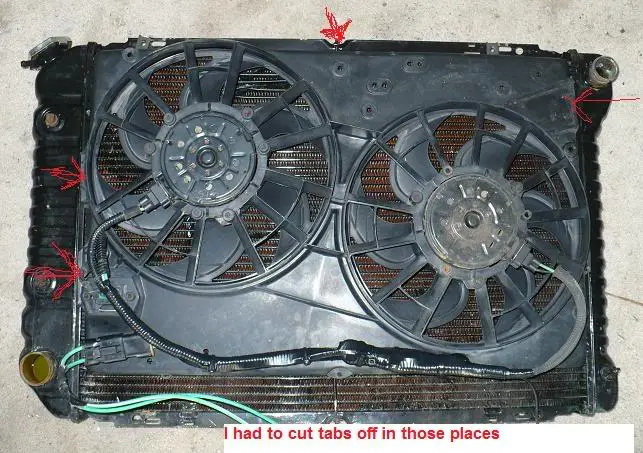

I pulled on the radiator tonight. I also trimmed off all of the unnecessary mounting tabs off of the fan assembly. Then I split the harness and removed the unnecessary wires and rerouted all the wires to the bottom, instead of the top where they were on the Contour. It looks much cleaner now. I forgot to take pictures. I will take some tomorrow or Thursday when I mount it. I think I have it figured out how I'm going to do it.

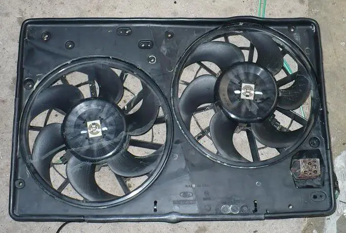

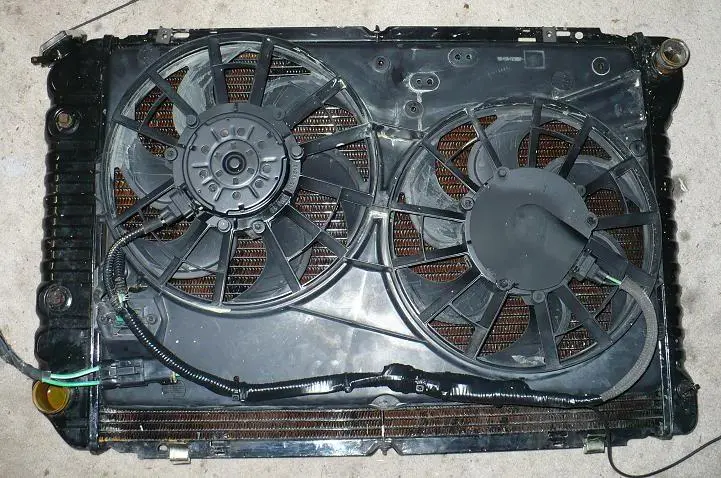

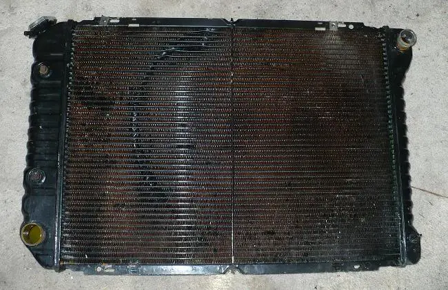

I still haven't touched it buit here are a few pictures.
Fan assembly
Radiator Looks like the fan almost went through it a one time.
Fan on radiator, but not mounted yet.

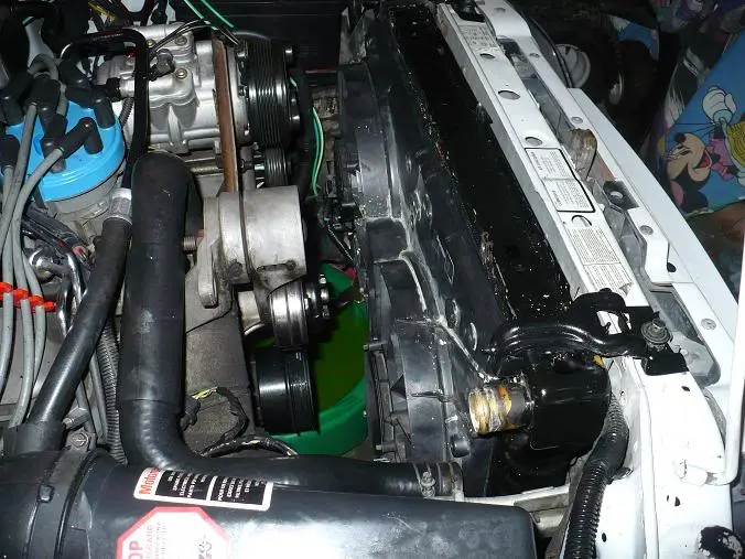

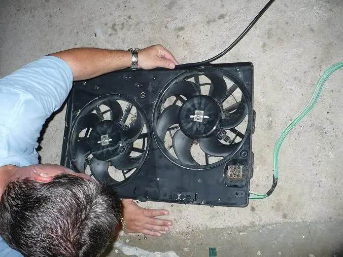

My buddy and next store neighbor Joe came over tonight to help out and he came up with a good idea of using vacuum hose split down the middle to cushion the fan against the radiator. 7/64 hose was a nice tight fit.
Here he is installing it.
Here it is with hose going all the way around.
Here it is mounted
Here it is just sitting in the car

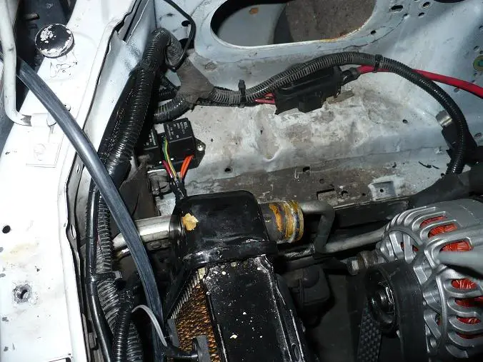

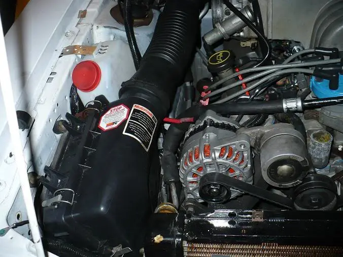

I got some more done today. I helicoiled the top hole on the 6G 130 amp alternator. I got it installed and all the wiring done on it. I mounted the fan controller and wired it all up except the 12V ignition wires and the clutch wire. I need to get some green and yellow wire from work tomorrow so I can finish that up. It looks great so far. I took a bunch of picture, but when I went to download them the file was kerupt and I was only able to save 2 of them.
The controller mounted. The 4 gauge power wire for the new alt. I also installed a 175 amp fuse from a 1999 F150. That's what is in the small black box.
I just set everything in there to see what it would look like. That's a cheap universal overflow bottle I got from work. When I pull the engine next year and get a CAI I will upgrade to something nicer. Right now that fits pretty good and will serve the purpose.
