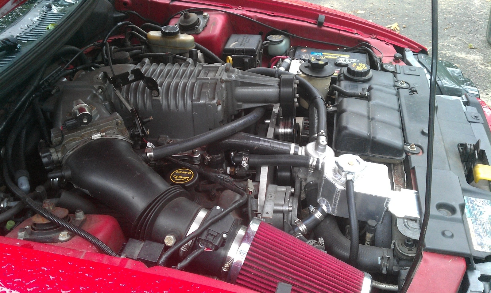

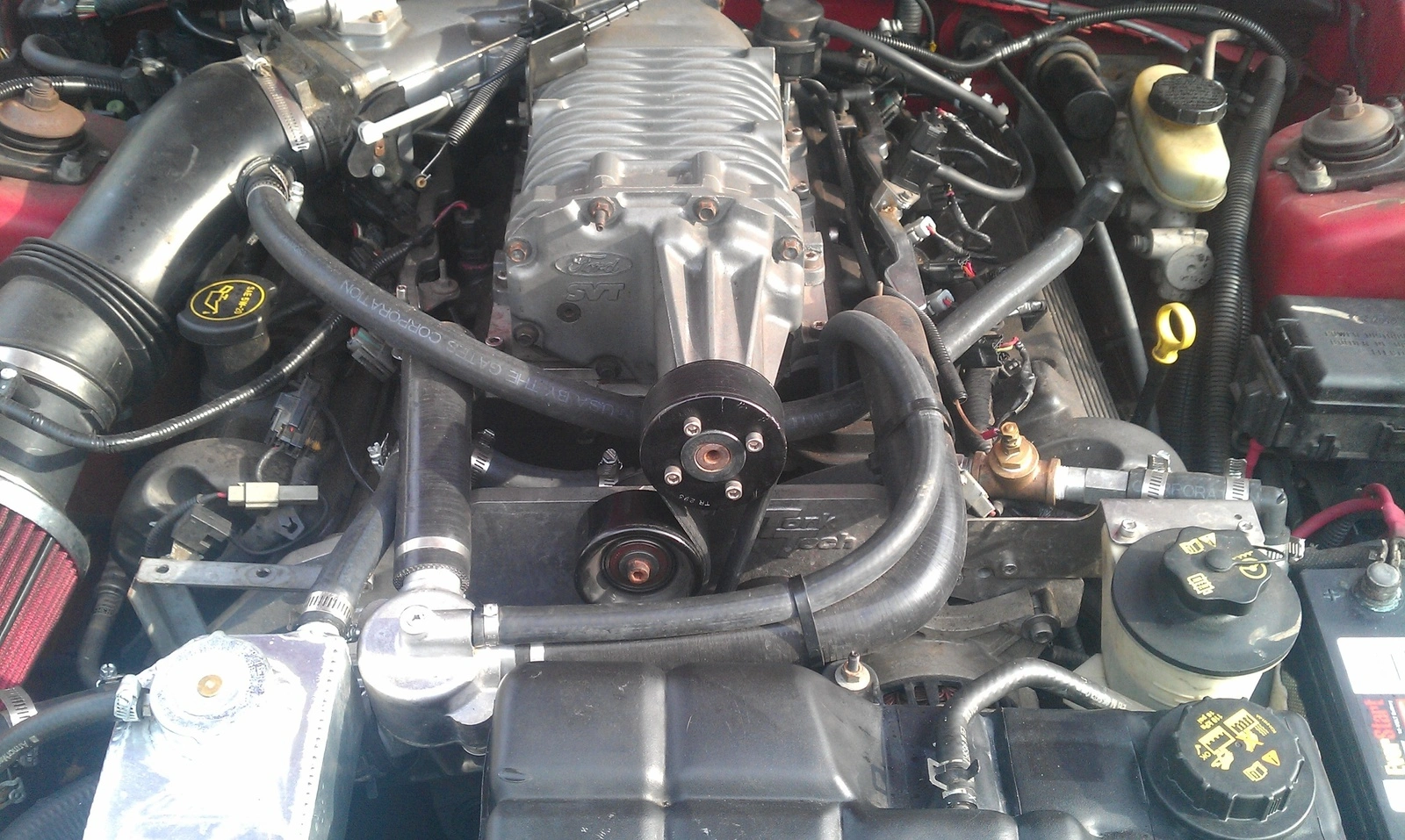

Yea they are a pretty clean look. I think the Saleens run a whipple I'm not 100% sure. I put down 410hp at 9lbs boost intercooled
