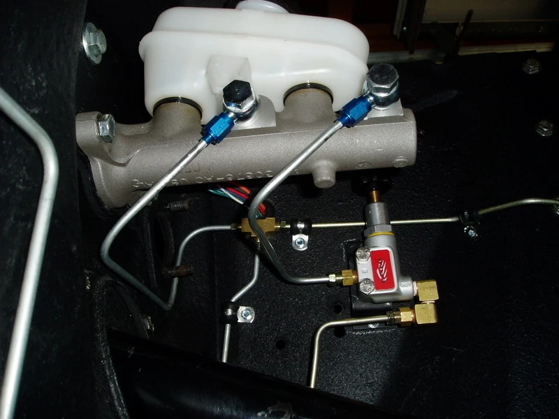

Here is my setup
http://i98.photobucket.com/albums/l259/rsowell_2006/P9270006.jpg
