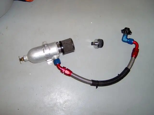

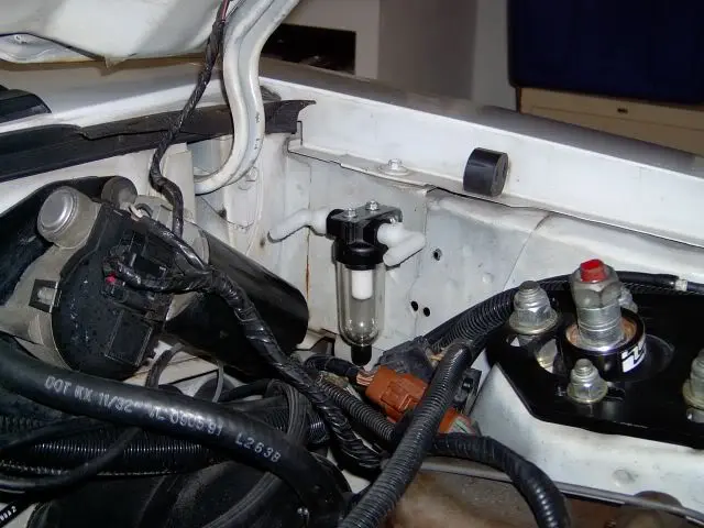

Yeah, I've been going back and forth about the PCV / breather thing. I actually had breathers and no PCV on my last motor, but it didn't last very long. So now I'm thinking I'm gonna go back to a PCV system with an air/oil separator. It's gonna be a new shortblock, so hopefully blow-by and leaks won't be too bad
Newly mounted air / oil separator
Old breather / catch can set-up
