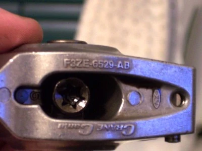

Here is a picture of the rocker.

ashford said:
f3ze translated 93, mustang, engine ford number. looks like ford contracted crane to make rocker arm for them, no they wont work
Thanks ashford, I was doing some research and I believe you and CETV are right. They are crane rockers that were contracted out by Ford Racing. I'm glad I started this thread to find out if the rockers would not work on the AFR heads, saved me some money, thanks for the help!!
