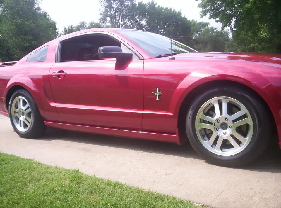

First of all, sorry for the troubles you're having with your springs - that sounds crazy. I'll be honest - I couldn't be happier with these springs so far. No noises, but I didn't have any noises with the factory springs like some have reported. The ride quality is about what you would expect, and I suspect the 19" tires/wheels are the major contributors. It's completely acceptable though, and it's very crisp and responsive in the twisties. I'm still running the factory shocks and struts, but I plan on adding Bilsteins at some point. This is my first set of H&R springs, and I'm very impressed. I don't think I would be as happy with H&R's other springs that drop the car more, and I was looking at the Steeda and Roush springs for the same reason before I purchased. Good luck with your car - I hope they make it right for you no matter what that involves.
I havent experienced any sagging with my Pro Kit and the cars rides very nice.
killertomato said:
But did you have to replace the pan hard when you put in the Eibach Pro kit?
No, didnt see a need to replace it with an adjustable one. I have heard people say that you need to but the rear end did not shift one way or the other and the car has been through many hard launches since the install.
