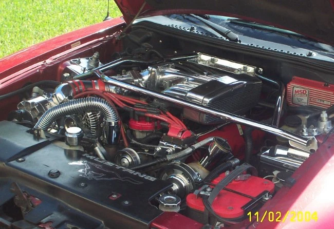

Here's another option..
I also ran these chromes before..requires a 1/2" spacer...Only prob is they cant really be seen....
TFs or the like will be much easier..
Mostly the spacer is for cooler air intake, denser air makes more power...Run you car and then put your hand on the upper...its screaming hot....Pop in a spacer and you can run the mother all day and lay your hand right on it, hardly warm...the heat from the lower doesn't transfer to the upper with the spacer...
