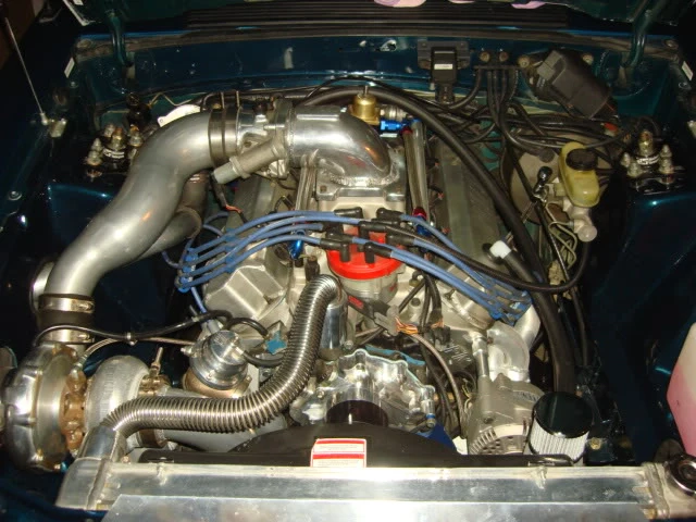

I ran the same type of set up as you with the S trim, the turbo set up has a vented catch can with no return to the intake tract.
Nope wide open. This set up is widely used in the turbo world and recommended by my tuner as well.
I do not have much seat time in the car with this set up as of yet as I am just finishing up some small things now.

Grover, I didn't know that your setup was non-intercooled. Are you using methanol injection to cool things down? Is that what the pink fluid in the plastic tank is?
Once you get some more seat time, keep us update regarding your blow-by issues. I have an RNH 331 in the works that will also be turboed and I'm trying to determine the best way to tackle crankcase evacuation. I know the valve cover vent lines are popular, but I'm a little concerned about getting accurate MAF readings with a setup like that.
