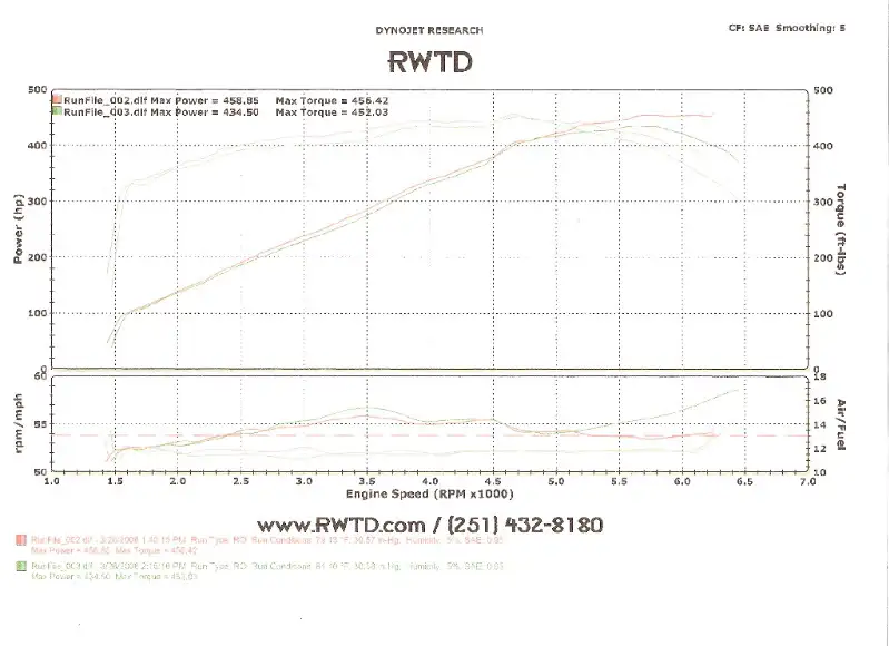

I have 4.10 gears but with 28" tires I have an effective gear ratio of 3.92
Here is the graph:
In the AFR box, the bottom two lines are the AFR, perfectly flat at 11.7-11.8.
The other two lines are my effective gearing. They are supposed to be smooth humps but you can see they are squiggly. Where they drop down suddenly is clutch slip and where they level out is it grabbing. The first instance of this is at 4500. You can see it on the hp/tq curves as a little hump/blip in the graph. At around 5000rpms it shoots WAY up...MASSIVE clutch slip. Decided to call it a day and let me drive on it for a while (has a safe tune in it) and come back when I have some more miles on it and retune and go from there.
So with some crazy clutch slip, I'm pretty happy with my 459/455 SAE corrected numbers
Hopefully with a grabbing clutch I'll make my goal of 480rwhp and 470ft-lbs
Here is the graph:
