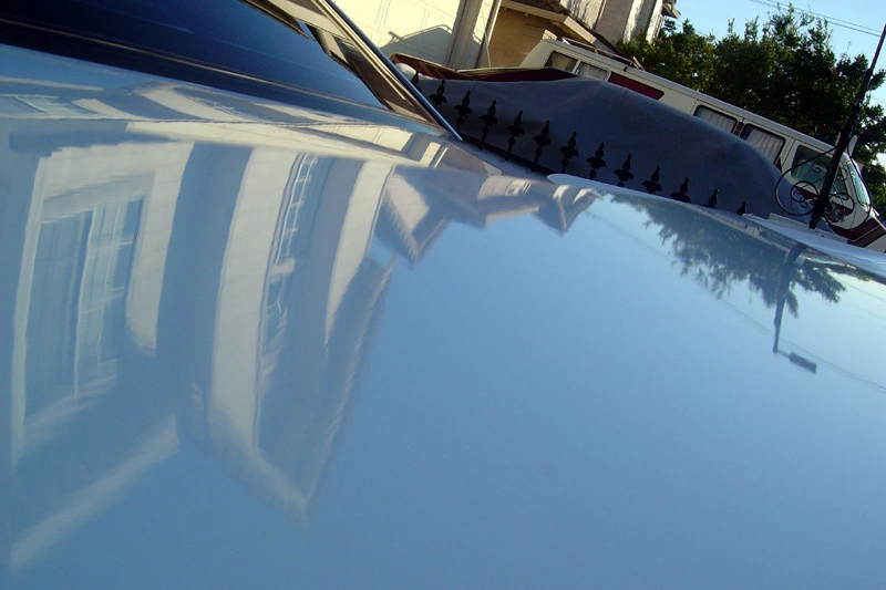

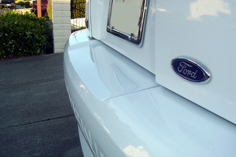

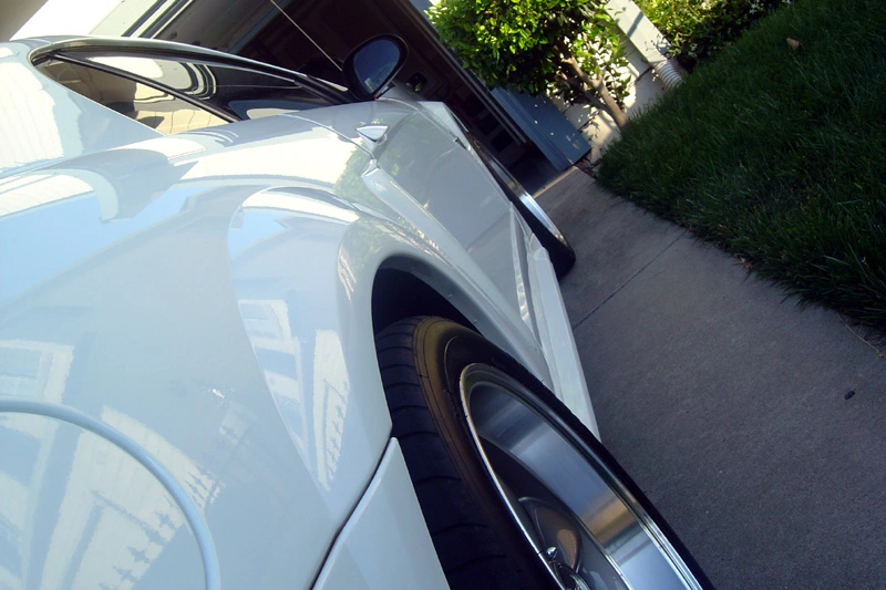

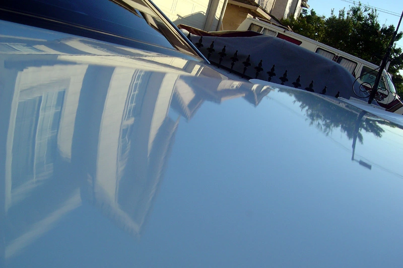

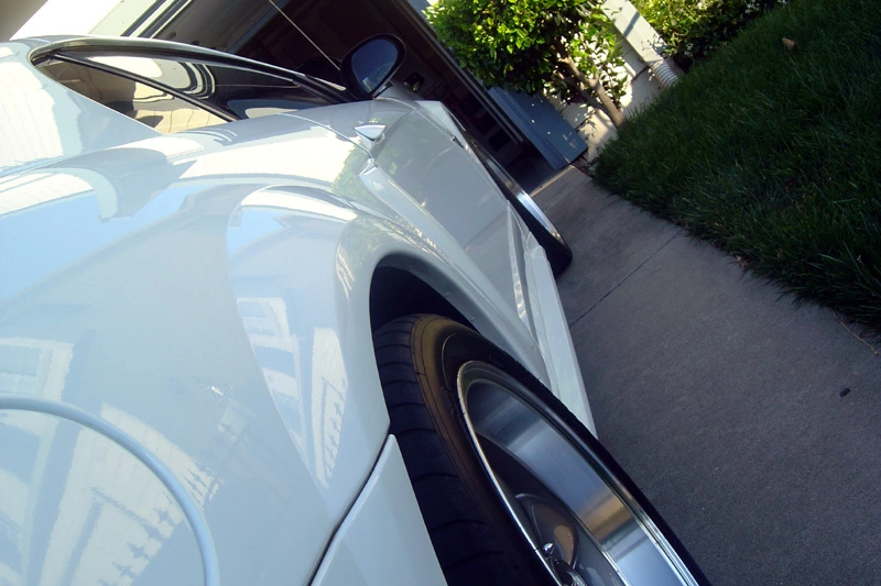

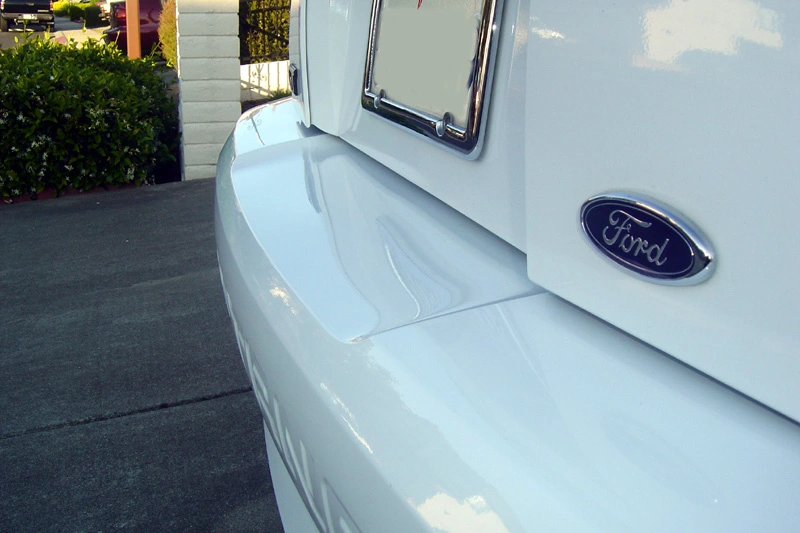

Sun was going down so I only got a few good ones today. Not enough time/room/sun/good angle to get full sized pics, but closeups are good. :)
I'll try to park it inside tonight so I can get some more good pics..
Rear bumper... no tiny contaminates anymore!
Spoiler

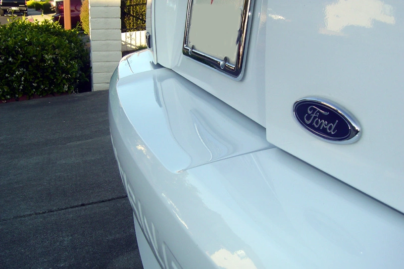

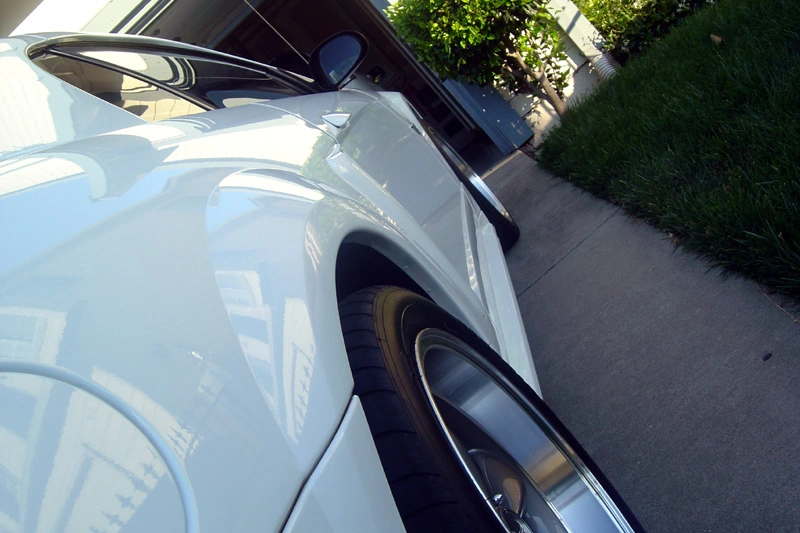

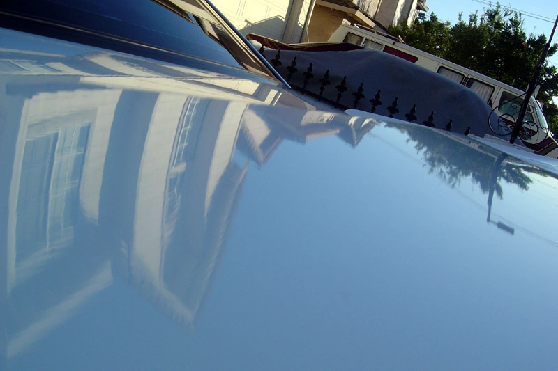

Spoiler
post pics of the whole car
